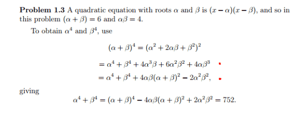

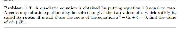

Textbook problem 1.3: A quadratic equation is obtained by putting equation 1.3 equal to zero. If alpha and beta are the roots of x^2 - 6x + 4 = 0, find the value of alpha^4 + beta^4.
The problem equation is contained in the picture.
Pascal's Triangle is useful is this one.

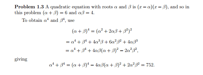

The difficulty I'm having is in going between lines 2 and 3 which I've marked with a little red dot.
Typeset worked expansion of (a + B)^4 = (a^2 + 2aB + B^2)^2 expanded to a^4 + B^4 + 4a^3B + 6a^2B^2 + 4aB^3, then regrouped as a^4 + B^4 + 4aB(a + B)^2 - 2a^2B^2, ending with a^4 + B^4 = (a + B)^4 - 4aB(a + B)^2 + 2a^2B^2 = 752.
The closest I get to simplifying it is = a4 + B4 + 4aB(a2+B2) + 6a2B2 . From there I can't figure out the way in which to reduce it further.
P.S I also used the quadratic formula to solve this one (the one with the b2 - 4ac) and my answer came to 748.52 but not quite 752. Why does the quadratic formula not work here?
Thank you for your help,
Ben
  • Worked expansion of (alpha + beta)^4 using Pascal's triangle coefficients 1, 4, 6, 4, 1, rewritten as alpha^4 + beta^4 + 4alpha beta(alpha + beta)^2 - 2alpha^2 beta^2, giving alpha^4 + beta^4 = 752.
##\alpha^4 + \beta^4 + 4\alpha^3\beta + 6\alpha^2\beta^2 + 4\alpha \beta^3 = \alpha^4 + \beta^4 + 4\alpha^3\beta + \color{red}{8}\alpha^2\beta^2 + 4\alpha \beta^3 - \color{blue}{2\alpha^2 \beta^2} = \alpha^4 + \beta^4 + 4\alpha\beta(\alpha^2 + 2\alpha\beta + \beta^2) - {2\alpha^2 \beta^2}##
Now use ##a^2 + 2ab + b^2 = (a+b)^2##
