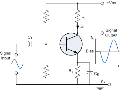

Think of an NPN transistor with DC bias resistors. It is operating at a DC bias point (collector voltage and current) with no input signal. That is the Q point. Now, connect a capacitor to the base so you can inject signal. An AC input signal will cause the currents and voltage to change along the load line. If you inject enough signal to saturate, that will define the upper operating point. If you cutoff, that will define the lower operating point. Draw a line between the two points and you get the different operating points as the input signal varies. 0 volts input takes you back to the Q point.http://collections.infocollections.org/ukedu/en/d/Jgtz040e/7.1.1.html explains a way to determine the axis intersections for the load line

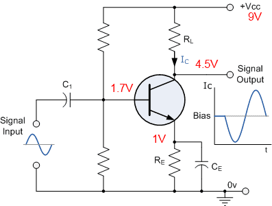

A transistor only works as a transistor when the voltages on the base, collector an emitter are within certain ranges. For example the base voltage must be around 0.7V wrt the emitter. So bias resistors are used to set the base to this voltage with no input signal. This is the q point for the base. The input signal only changes the base voltage very slightly away form the q point. Similarly the collector voltage must also be biased to a q point or the transistor won't work as intended.
Edit: I've added typical DC bias voltages or Q-point voltages to the drawing assuming a 9V supply voltage.

No signal means (in this circuit) no AC input through the capacitor. Even when there is no AC signal, the transistor is conducting current due to the bias currents into the base through the base resistors. The transistor needs to biased such that there is a "midpoint" output voltage when there is no signal input. The input signal can then cause the output voltage to go above and below the "no-signal" bias point as shown in the picture.

In this figure the input signal comes to base through capacitor C1
Actually when input is given the base must be dc biased and this point when ac of input signal becomes zero and dc base becomes dc biased is Q point.
If I am true then how alone this capacitor can convert ac into dc
please correct if required

The capacitor does not "convert" AC to DC,
The AC input is centred around 0V. The base voltage is centred around 1.7V. The capacitor blocks the DC difference. The capacitor allows the AC component of the input to be superimposed on the base.
