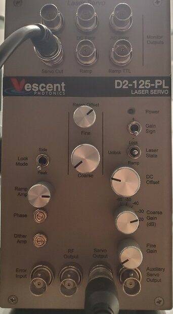

Thanks a lot for this! The laser company replied, and you were totally right in terms of parameters. They show how fast I can modulate the laser, how much the wavelength changes per voltage applied and the range of voltages I can apply.
I attached below a picture of the actual servo. I emailed the servo company these questions, but I thought it's worth asking you, too, as you are just as right and a lot faster (I will try the ideas with an oscilloscope first to make sure I don't break the laser). I would actually want to scan my laser frequency at a lower frequency that the one they provide in ramp mode (they use 500 Hz). You said I can use the Ramp TTL port. Does it mean that I can just create the signal I want with a signal generator, plug that signal in the Ramp TTL port and that will replace the 500 Hz default signal?
About the voltage of the servo, in the ramp mode that is not a problem. Keeping the amplitude below +/- 4V is enough to see the modes of my cavity. However I am a bit worried about the locking phase. The voltage produced by the servo in this phase is between +/- 12 V. In principle that voltage used should be very small (below 1V?) as that is just a fine tuning used to follow the cavity modes closely. But I am worried that if the lock is lost, the servo might send a voltage much bigger than +/- 4 V to relock it. Is there a way to avoid this? I was thinking to use a voltage divider, that would send to the laser only 1/3 of the voltage generated by the servo, but I am not sure how this would work during the fine tuning. I assume that also the fine tuning voltages will be divided by 3 and that might affect the lock?
Actually, another thing I am not sure about is how does the servo know how much voltage to send (I assume that different lasers have different values for MHz/V parameter). I understand that the PID is used for that, but from my basic understanding that should still require a lot of fine tuning in order to adjust the weights for the 3 path (actually 4 in my case as the loop is a PIID).
Because this laser has such a narrow linewidth, you might want to be careful adding protection circuitry to the modulation input. 5 kHz linewidth and 100MHz/V means that a mere 50 ##\mu##V will move the laser center wavelength by a whole linewidth.
The most common form of voltage protection is a pair of Zener diodes. I'm stuck on my phone until Monday or I'd draw you a circuit. Check out the Wikipedia page on Zener diodes (https://en.wikipedia.org/wiki/Zener_diode) and scroll down to the "waveform clipper" subsection in the "uses" section. That would do the trick, but it will add noise, which will effectively widen the laser linewidth. I don't recall how to calculate the noise in nA/sqrt(Hz), but you multiply that by the impedance of the modulation input (probably 50 ohms) to get the voltage noise (and by extension the freauency noise in Hz/sqrt(Hz)).
I only see a coarse and fine gain on the front panel. Are there more controls for the gain paths?
Edit: I wrote microhertz earlier when I meant microvolts. Fixed.

Thanks for this! Do you mean that due to this high sensitivity to low voltages, the locking might not work that well? Shouldn't the servo account for that sensitivity? That was basically related to my previous questions: given that all lasers are different, shouldn't the servo somehow adapt to the laser sensitivity when correcting the frequency i.e. if I want to adjust the laser by 1KHz, and one laser need 100 mV while another one needs 100 ##\mu##V, shouldn't the servo account for that on its own, or do I need to build an external circuit to connect the laser to the servo for each laser I have?
There are no other controls for the gain paths.

Eh, it's more you than the servo. You setting the servo's setpoint to a known spectral feature is what determines the laser frequency at the end of the day. Servo's are great, but they aren't going to steal your job :oldtongue:
You probably were not meant to fiddle with the integrating gain in that case. The only other place I could think it would be would be on one of the side panels. Look for holes in the side panels, with trimmer potentiometer screws visible inside. Even if you do find it, I would assume that you don't need to mess with it unless you see weird slow drifts in your lock voltage. And even then, I would look for optical feedback before I started messing with the integrating gain.
