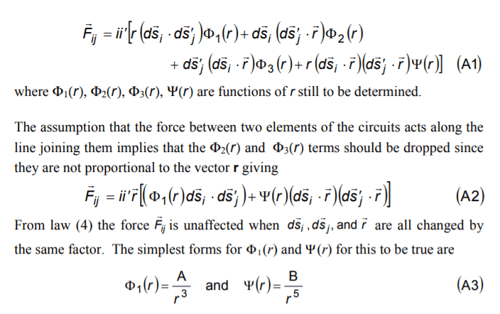

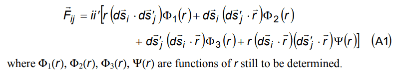

I'm reading about the derivation of ampere force law formula, which is $$ F=k_A \iint \frac{i'ds' \times (ids \times \vec{r})}{\vec{r}^2}$$ where K_A is mu_0/4pi. In the article that I read, they have assumed such these paths:
And according to ampere's conclusion that he had from observation is that the effect of a current flowing in a circuit twisted into small sinuosities is the same as if the circuit were smoothed out. And then in the article they came up with the following equation (A1):
So I guess that it came from vectors analysis, but I can't actually figure out how they got it...! In addition, my second question would be about equations (A3), why it would be the guess and why they are the simplest forms and not for example 1/r^2?
I would be grateful for explanations and thank you in advance.
The article is: Derivation of the Universal Force Law—Part 2 Charles W. Lucas, Jr. 29045 Livingston Drive Mechanicsville, MD 20659-3271
The text itself says otherwise:
... So it's just counting:
And if e.g. ##\Phi_1\ ## would be proportional to ##\displaystyle{1\over r^2}\ ##, then ##F## would not stay the same if all ##r## and ##s## would be changed by a factor of e.g 2: F would double !

It's very awful notation ;-). What's behind it is just Biot-Savart's Law for magnetostatic fields and the Lorentz-force law.
Let's start with the ##\vec{B}## field. The fundamental equations are Maxwell's equations,
$$\vec{\nabla} \cdot \vec{B}=0, \quad \vec{\nabla} \times \vec{B}=\mu_0 \vec{j}.$$
The first equation tells you that there's a vector potential ##\vec{A}## such that
$$\vec{B}=\vec{\nabla} \times \vec{A}.$$
Now ##\vec{A}## is determined only up to a gradient of an arbitrary scalar field (gauge invariance), and thus you can impose one "gauge constraint", which in this case is best chosen as the Coulomb-gauge condition,
$$\vec{\nabla} \cdot \vec{A}=0.$$
Then plug this into the 2nd equation:
$$\vec{\nabla} \times \vec{B}=\vec{\nabla} \times (\vec{\nabla} \times \vec{A}) = \vec{\nabla} (\vec{\nabla} \cdot \vec{A})-\Delta \vec{A}=-\Delta \vec{A}=\mu_0 \vec{j}.$$
From electrostatics ("Coulomb's Law") you know how to solve that equation:
$$\vec{A}(\vec{x})=\int_{\mathbb{R}} \mathrm{d}^3 x' \frac{\mu_0 \vec{j}(\vec{x}')}{4 \pi |\vec{x}-\vec{x}'|}.$$
Taking the curl leads to Biot-Savart's law for arbitrary current distributions
$$\vec{B}=\vec{\nabla} \times \vec{A}=\frac{\mu_0}{4 \pi} \int_{\mathbb{R}} \mathrm{d}^3 x' \vec{j}(\vec{x}') \times \frac{\vec{x}-\vec{x}'}{|\vec{x}-\vec{x}'|^3}.$$
If you now idealize your loop as an infinitely thin wire you have (by choosing the appropriate sign for the direction of the path)
$$\mathrm{d}^3 x' \vec{j}(\vec{x}')=\mathrm{d} \vec{x}' i,$$
leading to
$$\vec{B}(\vec{x})=\frac{\mu_0 i}{4 \pi} \int_{C} \mathrm{d} \vec{x}' \times \frac{\vec{x}-\vec{x}'}{|\vec{x}-\vec{x}'|^3}.$$
Now the force on a little charge element in the other loop is
$$\mathrm{d} \vec{F}=\mathrm{d} q \vec{v} \times \vec{B}=i \mathrm{d} \vec{r} \times \vec{B},$$
from which you get the claimed result integrating over the entire loop ##C'##
$$\vec{F}=\frac{\mu_0}{4 \pi} \int_{C'} \mathrm{d} \vec{x} \times \int_{C} \mathrm{d} \vec{x}' \times \frac{\vec{x}-\vec{x}'}{|\vec{x}-\vec{x}'|^3}.$$

Thank you so much for this approach, that's really helpful :)

Thank you a lot for your comment. Actually I didn't understand what do you mean about counting...? And how did you deduce that from the law number 4 and what does that mean?
Regarding function ##\Phi##, how it stay the same with power 3 (or power 5)?!
You count the places where ##d\vec s## and ##\vec r## occur. The ##\vec r## in front of the [ bracket is common and ##\Phi## is followed by ##d\vec s_i\cdot d\vec s_j##. So if all are changed by factor of 2, ##\vec F_{ij}## can only stay the same if ##\Phi## is changed by a factor of 1/8 .
For ##\Psi## 1/32.

Maybe now I have some direction to think about it, thank you :)

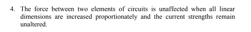

Lucas said:
Ampère [17] performed a series of four experiments and found that the force between two current elements in current loops obey the following laws:
  1. The effect of a current is reversed when the direction of the current is reversed.
  2. The effect of a current flowing in a circuit twisted into small sinuosities is the same as if the circuit were smoothed out.
  3. The force exerted by a closed circuit on an element of another circuit is at right angles to the latter.
  4. The force between two elements of circuits is unaffected when all linear dimensions are increased proportionately and the current strengths remain unaltered.
From law (2) the effect of ds on ds’ is the vector sum of the effects on ds’. From law (1) which supports Newton’s third law of action and reaction plus the assumption that the force is linear and homogeneous in ds and ds’, the simplest general formula must be
Isn't that just the sum of what is left over of the possible varieties ?
