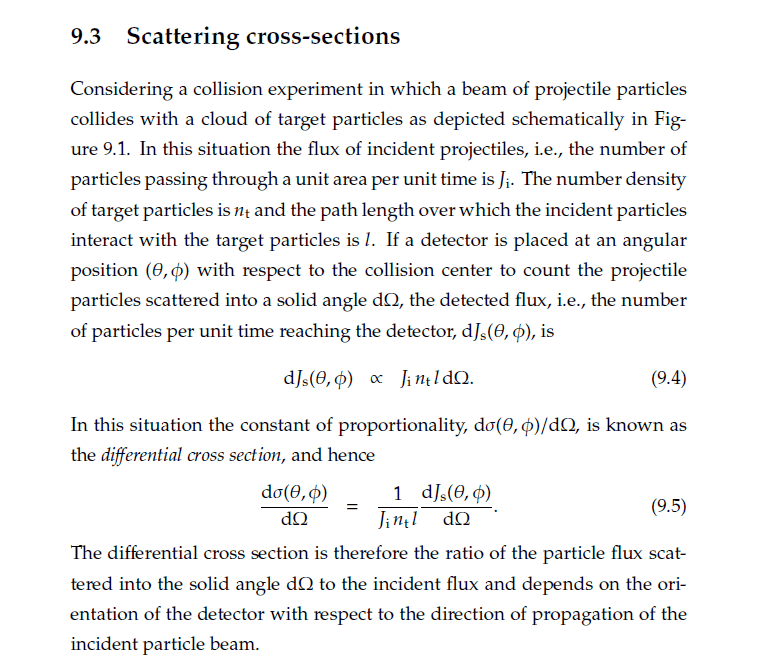

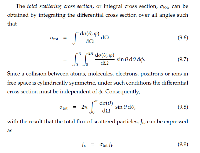

I have attached the two pages in my notes and I have the following question.
1. Where have the n_t*l gone in 9.9? (According to 9.5 why do they disappear?)
2. Why J_s=sigma_tot J_i? The dimension of flux is per m^2 and sigma is per area too, the dimension is not right...

Looks like an error to me...
Yes, insert ##n_t l## into (9.9) in such a way that the units are consistent on both sides.
A physical reality check: if ##l = 0## or ##n_t = 0##, i.e. the target disappears completely, what should we expect ##J_s## to be, regardless of ##J_i##? :smile:

Yes, it should be zero :)
