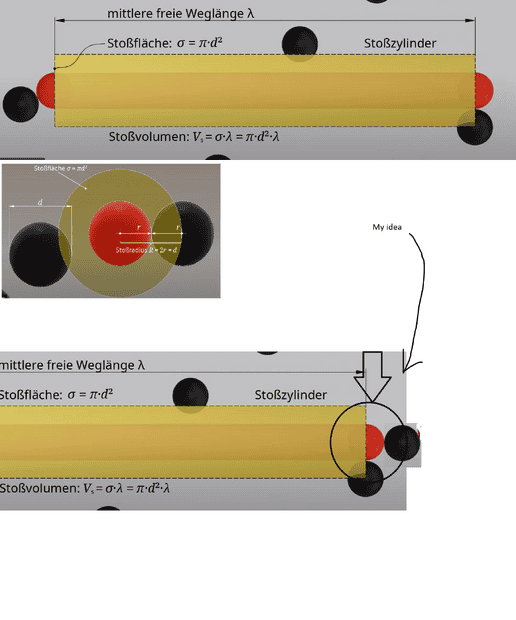

Hello,
I have a question regarding the ideal gas and the average free movement of a single molecule. For simplicity, let's consider a model where we have only one atom moving, and we assume all atoms have the same radius.
First, we calculate the cross-section σ using the formula σ=d², where d is the diameter of the atom. After obtaining the cross-section, we calculate the average free movement λ.
Next, we multiply these two values, σ⋅λ to find the volume associated with the average movement.
However, I wonder if this formula is correct. Shouldn't we also consider adding a half-sphere at the end of the cylinder to account for potential collisions? Would the complete expression then be σ*λ + (4 *π* d)/2?
Thank you for your insights!

If we are talking about ideal gas we assume it is not too dense, so most likely σ*λ >> (4 *π* d)/2 and the latter can be safely ignored.

Thanks for your reply, but i am interested in the exact formula, so this "σ*λ >> (4 *π* d)/2" is right, but my question is, if we need the (4 *π* d)/2 for die total correct formula.

The cross section for collisions ## \sigma=\pi d^2##, because the cylinder of collision assuming hard spheres, has radius ## d ##. You can do some very precise calculations assuming the atoms move in straight lines and collisions occur within this cylinder of radius ## d ## which has cross-sectional area ## \sigma ## and get that the mean free path ## \lambda=1/(n \sigma ) ##, where ## n ## is the density=number of atoms per unit volume.
Each atom, i.e. the atom you are studying, (the others can be assumed to be points in regard to this atom), basically makes a cylinder of volume ## v= \sigma \lambda ##, and when ## n v=n \sigma \lambda=1 ##, that sort of defines ## \lambda ##.
(This formula for mean free path, ## \lambda=1/(n \sigma ) ##, is widely used and well-established. I remember discussing it many years ago with a well-known plasma physicist, Professor Manfred Raether (RIP) at the U of Illinois in Champaign-Urbana).

Thanks for your replay! So you think the first formular in the pic is right? My idea was die image under the "classic one". Because the atom can push an atom on the same "line they moved" to, or? An then this atom is not in the cylinder?

Please see the addition I made just before you posted it (in post 10), where the atom under study makes the cylinder of radius ## d ##, and the others are regarded as points.
The formula assumes low density, so that ## \lambda >> d ## and you don't need to worry about the endcap.
