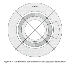

There are 2 primary flux paths in a permanent magnet brushless DC motor. One from the north face of a magnet to the stator through the coils/windings then into the south pole of the adjacent magnet. The other flux path would be from the backside of the magnets through the rotor metal they are attached to into the adjacent magnet.
This second path does not contribute to the overall torque of the motor. Does it matter if the metal in this second path gets over saturated with flux? The material of the rotor would get to non linear magnetic operation... but would that affect the first flux path at all and the torque?

This "second path" is really part of the same path as the "first path". The flux must complete a circuit, just as electric current must. The total flux in the circuit is limited by the total reluctance of the circuit, given a fixed mmf.

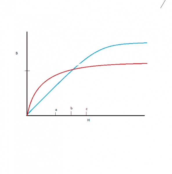

When it saturates, the flux can only increase as it would in free space. But if we achieve a suitable level of flux, whether the core is saturated or not at this point, may not be important.

Here the blue curve is the iron and the red is some other material with higher μ but lower saturation. If you were originally operating at H=a, then changing materials would increase B, even though the material is now approaching saturation.
If you were operating at H=c then the saturation of the new material would prevent it reaching the same B as the iron.
At H=b the change of material would make no difference. Even though the new material was pretty near saturated here, B and H are the same.

View attachment 105811 Here the blue curve is the iron and the red is some other material with higher μ but lower saturation. If you were originally operating at H=a, then changing materials would increase B, even though the material is now approaching saturation.

Hmm. Thanks man. When you said it is all a complete circuit... I went back and found this picture :
Yeah, it looks like it is a complete circuit, so if the rotor was saturated than it would affect the flux through the coil. I thought it was 2 separate flux paths for some reason.
I guess when it saturates it increases the reluctance over air in a non linear fashion, but the flux up until that point is fine. Never thought about what would happen until now I have just been trying to make the metal thick enough to avoid that. Thanks again!
