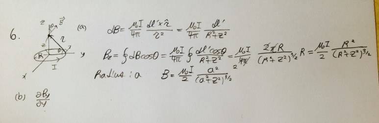

This is what i did about (a)

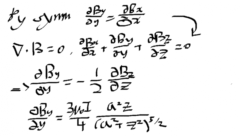

but i don't know how to approach (b), it doesn't have x,y components, only Bz component.
I think your answer to a is right - not expert in this area.
For b, a dependent variable being zero at some value of the independent variable does not imply that its derivative is also zero there.
I suggest working on b2, returning to b1 afterwards.

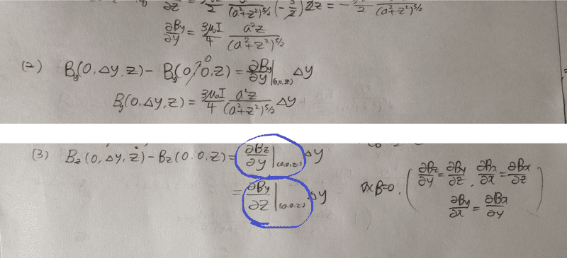

I think i solve (1), but the problem is (2),(3)
BREAD said:
I think i solve (1)
And very neatly too.

These are easy. Fundamental differential calculus: f(x+Δx)≈f(x)+f'(x)Δx.

I tried it , but is (2) right? and idw how to get ∂(B_z)/∂y|_(0, 0, z). I heard somewhere that by properties of curl of B (as i wrote)
∂(B_z)/∂y|_(0, 0, z) is changed to ∂(B_y)/∂z|_(0, 0, z), but i can't solve this.

Isn't By identically zero on the z axis?
