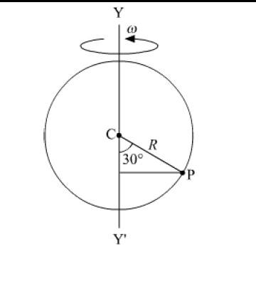

A small bead is fixed on a circular loop of radius R as shown in the figure below. The
loop is rotating about YY axis with constant angular acceleration ‘α’. The loop starts
from rest, then, the bead is in circular motion, then acceleration of the bead at instant
‘t’ is_______.
Angular Acceleration equation
Homework Statement: A small bead is fixed on a circular loop of radius R as shown in the figure below. The
‘t’ is_______.
Homework Equations: Angular Acceleration equation
Diagram of a circular loop of radius R rotating about the vertical axis YY', with centre C and a bead P on the rim; the radius CP makes a 30° angle with the downward vertical from C, and an arrow marks angular velocity ω.

If I'm interpreting the problem correctly, then the bead cannot slide along the loop. It is fixed at point P. So, I think this is just a kinematics problem. No need to consider forces.
