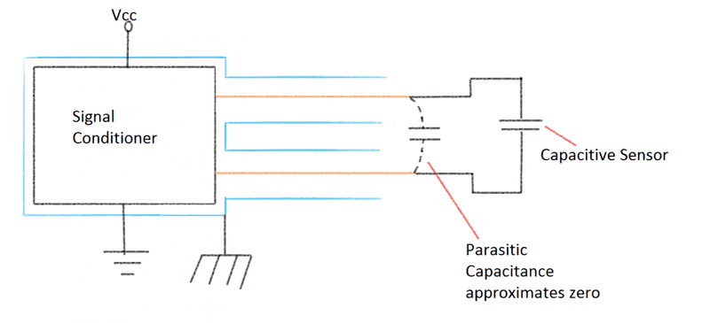

Hey guys, so the other day I had a course about capacitive sensors and this thing below came up.
The capacitive sensor is connected to the conditioner via two coaxial cables, the outer conductor of those cables are conected to a metallic casing which is also conected to physical ground. The parasitic capacitance is supposed to be really small when connected in this arrangement. The point of connecting to physical ground is having a different potential from the one of circuit´s ground. I asked my teacher why would we need to connect the casing to physical ground and he explained it to me but at the end I didn't understand.
I remember doing tests at the lab with capacitors. Whenever we needed to get rid of the charge in a capacitor we would just touch both of its terminals with a resistor in our hand. I heard charges in the capacitor were attracted to ground because we were standing in it. I also read that negative charges would be attracted to physical ground because of the abbundance of positive ones in it. As Capacitance equals Charge over voltage I thought parasitic cappacitances would reduce if accumulated charges were taken away from our parasitic capacitor. However, I'm not sure about any of that.
If you shed some light on this I will really appreciate it.

Davenn thanks for your answer, nevertheless my doubt is about how the fact of connecting the outer casing to physical ground is supposed to almost nullify the parasitic capacitance in the cable.
Thanks

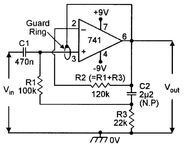

It doesn't. You would need to "bootstrap" the parasitic capacitance to reduce/eliminate it. Maybe that's what your teacher was trying to say?
That's where you drive a shield with a buffered version of the input signal, so there is effectively no changing of the voltage between the input signal and its "bootstrap guard/shield"...
http://www.nutsvolts.com/uploads/wygwam/NV_0801_Marston_FIGURE9.jpg
Dave & Berkeman are right.
Capacitance is area(of the wires)/distance(between them), a property of the cable's geometry.
connecting the shield to Earth does not change the cable's capacitance. But it might reduce the effect of that capacitance.

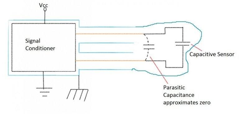

The basic idea of shielding is to surround the whole measurement system with a Faraday cage.
(and no, parasitic doesn't approach zero . It's fixed. We try to drive its effect to zero.)The reason for surrounding it with that cage is to prevent current that would otherwise flow into the sensor circuit through its distributed parasitic capacitance to earth.
You want those currents to flow in the shield, not in the sensor wires.

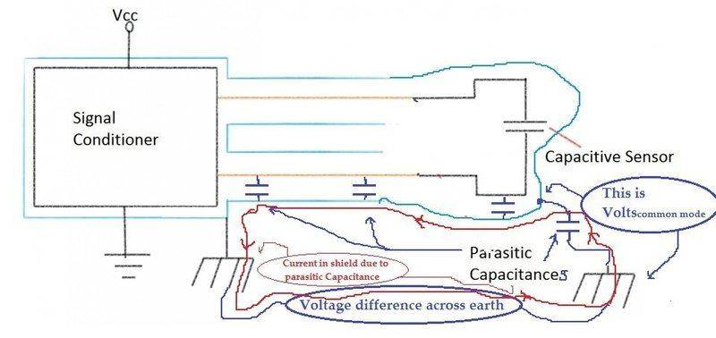

So i'll erase that "parasitic capacitance" you showed because it's in parallel with the sensor and there's nothing you can do about it.
And i'll draw back in the parasitic (i call it "stray") capacitance that really counts.
This looks scary but read on - i explain each piece below...(i hope)
There's usually some small voltage difference along the earth. We call it "Common Mode".
In a single room it should be tiny but when cable runs get into the hundreds of feet or even miles, anything goes.
Observe your shield intercepts the current coming in through that rightmost stray capacitance, the external one between shield and earth. Vcommon mode / Xcstray
So long as the voltage between shield and orange signal lines is small, there'll be not much current through those internal parasitic capacitances into the signal wires..
That's about how most folks handle shielding.
The "driven shield" berkeman showed uses an ungrounded shield that's forced to same voltage as signal line so there's no current through those internal parasitics.This author Ralph Morrison

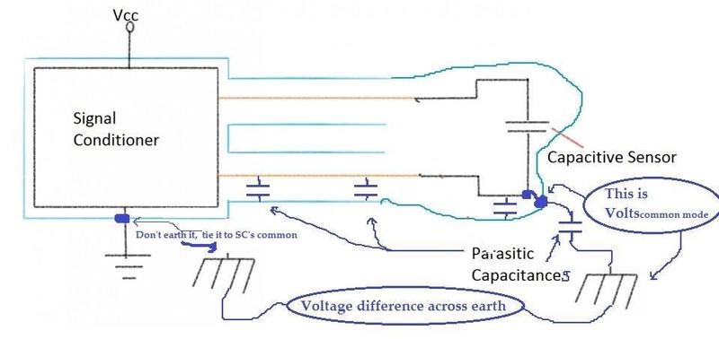

recommends minimizing voltage between shield and signal by connecting them at the point of measurement,
and carrying the shield to your amplifier's signal common.
Like this:
He emphasizes "It does no good to Earth the shield if the signal itself is not earthed."
But everybody Earth's their shields and usually gets away with it.

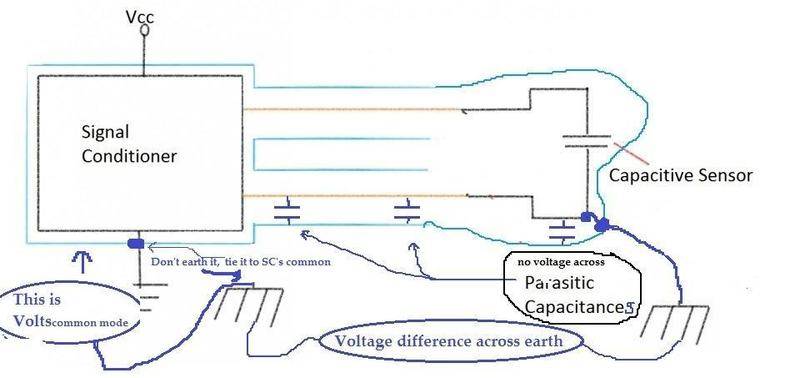

In my power plant nearly all shields were earthed as shown in that first sketch, which is same as yours except i closed the Faraday cage. door... We had a very few driven shields like Berkeman showed, they were for low millivolt AC signals on long cable runs.
Thermocouples are low millivolt DC signals susceptible to capacitively coupled noise. To resolve them accurately with our plant computer i had to use Morrison's technique. Fortunately the thermocouples we used were grounded type, so i connected each shield to its thermocouple way out there out at the pipes, where thermocouples were installed.
My multiplexer used 3 pole relays that switched all 3 wires, its plus minus and common, to plus minus and shield of whichever signal it was measuring at the time.
Results were most excellent.
But the folks who built that multiplexer understood the need for a guarded floating amplifier and 3 pole switching. It was exceptional for its day (early 70's)
Here it is, signal and shield both earthed only.at point of measurement.

So the takeaway from all the above is -----
With high level signals, like several volts, a measurement system can withstand some degree of abusive shielding practices.
To resolve fractions of a millivolt you need to be more careful.
I hope my disjointed diatribe gave you an insight to the principles.
Think Faraday cage and minimize voltage across parasitic capacitance..
It's really that simple.
