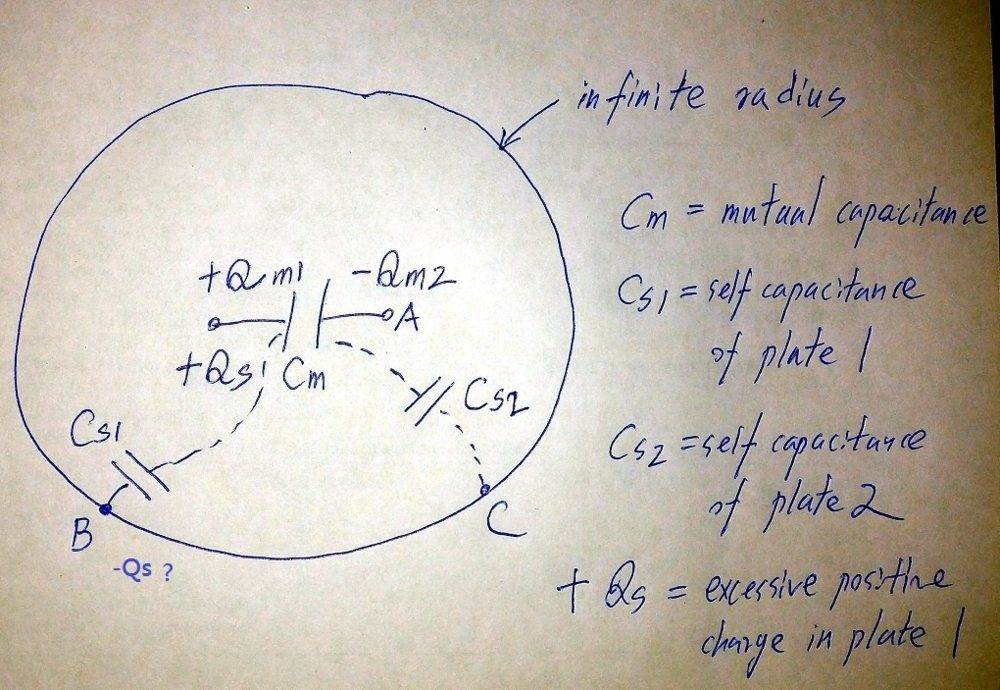

About whether it is series or parallel, I think it depends...🤔
Cm and Cs1 are connected in series between points A and B.
Cm is in parallel with two capacitors Cs1 and Cs2 connected in series.
Is this at least approximately reasonable?
Or is there a fundamental error?

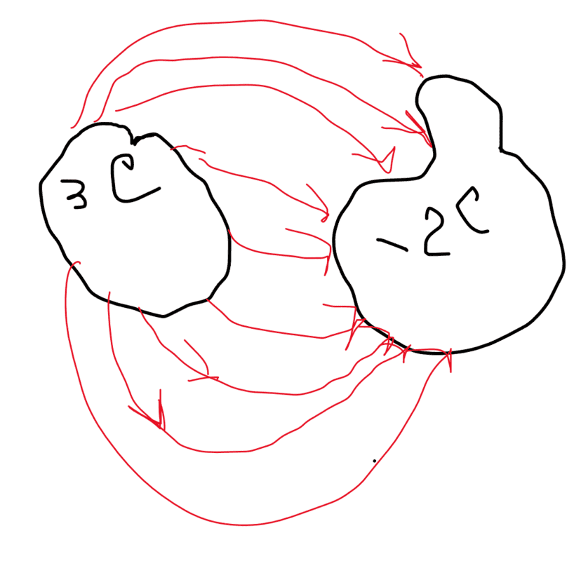

This is the simple situation I envisioned: two conductors with charge on them.
There is clearly an electric field and a net Coulomb force between the two conductors carrying different charges and I wondered if we can assign a capacitance to this system in virtue of the fact that it stores energy in the electric field, like a capacitor does.

Yes you can. You can use the classical approach of calculating the work required to bring those charges in from infinity to the positions in your diagram. (I personally hate that approach, but it gives the correct answer.)
If you reduce it to just two point charges, you can find solutions to that energy calculation already done in most textbooks on electrostatics.

Let's use a simplest example, there are only two arbitrary shape conductors A1, A2, and a common reference ground.
Method 1 :
We may model the system with a lumped model with discrete capacitors like the one shown in the image I posted.
Method 2 :
The other method is to represent it as a system of equations (capacitance matrix) as follows : -
Q1 = C11*V1+C12*V2 (C11 is the self-capacitance of A1)
Q2 = C21*V1+C22*V2 (C22 is the self-capacitance of A2)
Q1 = charge in A1
Q2
= charge in A2
V1
= potential of A1 relative the reference ground
V2 = potential of A2 relative the reference ground
Note that the capacitances C11,C12... in the capacitance matrix are different from the capacitances in the lumped model.
Thus the most difficult task is finding out the values of C11, C12..in the capacitance matrix or the capacitance values in lumped model. For a multi-conductor system with arbitrary shape conductors, simulation is an effective method to solve this problem.

Back to the questions on #1
For any charge Q1 in conductors 1, and any charge Q2 in conductor 2, regardless their amounts and signs, we can define the capacitance in two ways, either by Maxwell capacitance matrix or by mutual capacitance matrix.
We can find out the actual charges stored in Cm12, Cm11and Cm22 in the lumped equivalent capacitor circuit.
Step 1
Find the values of C11, C22 and C12 by measurement, analysis or simulation
Step 2
Find the values of Cm12, Cm11 and Cm22 using the relations below
Cm11 = C11 + C12
Cm22 = C22 + C21
Cm12 = -C12
Cm21 = -C21
Step 3
Use the elastance matrix to calculate the voltages of V1 and V2
V1=P11*Q1+P12*Q2
V2=P21*Q1+P22*Q2
Step 4
Find the stored charges in the mutual capacitors
Q12 = (V1-V2)*Cm12
Q11 = V1*Cm11
Q22
= V2*Cm22
I believe we can expect Q1=Q12+Q11 and Q2=Q21+Q22, where Q1 and Q2 are the charges we intentionally add to the conductor 1 and conductor 2, respectively. :smile:
