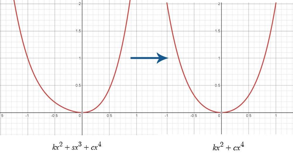

why the non linear hoock's law is given by : F_spring = ku + u^3 in this question ? i guess a u^2 is missing ?!
F = -kx-eu^2+...
hi guys
i saw this problem online about using the MATLAB ode45 to solve the nonlinear Hoock's law and its specifically stated that
the nonlinear hoock's law is given by
$$F = k\;u + \epsilon\;u^{3}$$ , but when expanding the potential function in a Taylor series where you obtain the force from it
it seems that the force is given by :
$$F = -\frac{dV}{dx}_{x_0} *(x)-\frac{1}{2} \frac{d^{2}V}{dx^{2}}_{x_0}*(x)^2+...$$
$$F = -k\;x-\epsilon\;x^{2}$$
the problem :
my question is where is the x^2 term ?? why did he jump directly to the x^3 term ?

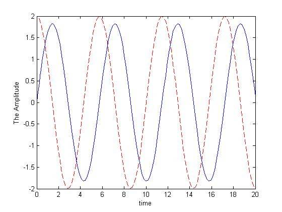

that's a really good explanation thanks a lot , i have a little bit of a stupid question 🤔 when i plotted this using Matlab ode45 with an epsilon = 0.2 it seems like any ordinary oscillating system ! , shouldn't i see some non linear behavior or something ? i was expecting some alien looking graph or something due to that extra ##x^{3}## term :smile: .
my Matlab graph :
The symmetric potential will display oscillatory motion regardless of whether it has terms higher than ##x^2## in it or not. There is nothing alien about it. The motion will not be simple harmonic, but how good is your eye distinguishing a pure sinusoid from what you plotted? That's perhaps part of the lesson to be learned here.

@TeethWhitener i guess you misunderstood my question
my question can be boiled down to this graph of the potential :
it was why not the left , and after all the arguments about the symmetry and some deeper physical reasons i am convinced that it should be the one on the right for this this specifically (symmetrically elastic spring) :smile: .
