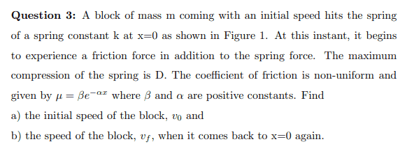

Oh,thank you!Here is my question,I just did not share the original version because I did not want to be understood as solving my question to you
  • Text of Question 3: a block of mass m with initial speed hits a spring of constant k at x=0; non-uniform friction mu = beta e^(-alpha x) acts; find a) initial speed v0 and b) speed vf when it returns to x=0, given maximum compression D.

I read the posted question and found the friction doesn't follow a simple, viscous-like, form. It states a position dependent friction coefficient. The posted equation, even with a null RHS, doesn't describe the system's behavior

So, how could you be sure of this result,do you have any suggestions on what to do or how to think?
I think you don't have a result, yet.
Hints: think about energy and work. Where does the work needed to compress the spring come from?

I know that work is equals the change in the particle’s kinetic energy.Now, we have a particle with initial velocity and it has also kinetic energy.We have friction force oppsite direction of the motion and we have also spring force.Then I thought if I wrote down (1/2mvinitial^2+kx=1/2mvfinal^2+friction force )but I don't think this might be right.It does not look like it is correct.There is a problem but I can't figure out.
You're adding apples (energy) to oranges (force).
Try again.

Let’s see your free body diagram of the mass

I believe the problem does not give enough information to calculate the value asked by a).

I believe there is enough information. I wrote the differential equation and found ##v(x)## then applied the given condition that ##v(D)=0##. This is equivalent to using the work-energy theorem as others have suggested. What piece of information do you think is missing?

I don’t get it, I am missing something for sure.
D point may or may not be reached, depending on how much kinetic energy is involved.
I will wait to see development of the solution.

D is defined as the point reached.

Not quite. D is a displacement. According to the statement of the problem (post #3, figure 1.png), "The maximum compression of the spring is D."

But x is measured from the tip of the relaxed spring, so the displacement and coordinate are equal.

Indeed it is. However, if the author's intention were "point D" as opposed to "displacement D" the statement would have been something like "At maximum compression, the mass is at x = D." We are mincing words here about the definition of "D" and 'tis not worth it. Instead, 'tis the season to be jolly - Happy holidays.

As I understand it, the problem says "At maximum compression, the mass is at x=D. Besides the strange friction coefficient, it's a nice example of the work-energy theorem.

As first noted by @Gordianus, think work/energy.
What expression gives the frictional force on the mass? Can you now derive an expression for the work done by the frictional force when the mass moves from x=0 to x=D? (Hope that's not too big a 'hint'.)
If you can do that, the rest should be straightforward.
