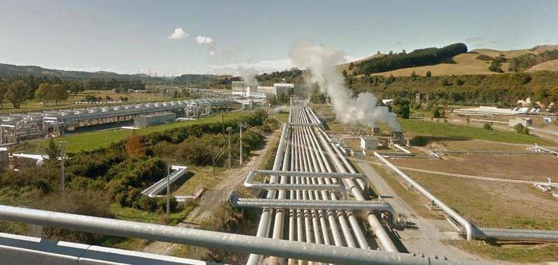

for where a number of the geothermal power stations are, none of the above is really applicable
take the geothermal power generation in Wairakei in the upper North Island of New Zealand. The geothermal heat/steam is going to be naturally released into the local surrounds regardless of if it is captured for power generation or not. Its been "pumping" superheated water/steam out of the ground long before man was around to worry about it and will be still doing so long after we are all gone
Gosh ... its been a long time since I last visited there
cheers
Dave
