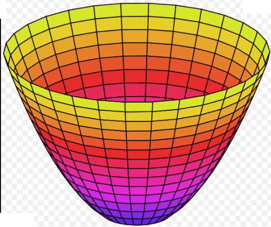

(d) I googled paraboloid of revolution to know the shape
So I need to find the equation of this shape to be able to find the time?

d) A paraboloid by definition has the form ##z = k r^2##.
