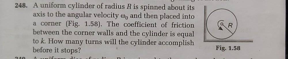

Find the number of revolutions by the cylinder.
$$ \tau = I \alpha $$
Change in Kinetic energy = Work done

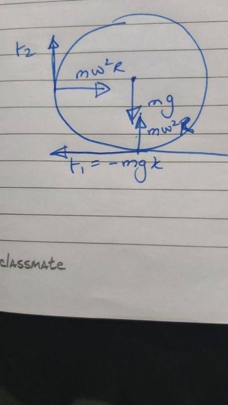

Hello, I'm stuck in this rotational motion problem (advanced high school level).
Source: Problems in General Physics- IE Irodov
My attempt(s):
First I tried using work done by the moment of friction (mgkR) and equated it with change in KE.
I got the answer as ## \frac{R (\omega_0)^2}{8 \pi g k} ##.
However, the correct answer is ## \frac{(1+k^2)R (\omega_0)^2}{8 \pi g k(1+k)} ## .
The first mistake I thought of is not including centripetal, but the centripetal is varying with ## \omega ## and whenever I solve it that way I am not even getting close to the answer. Using ## \tau=I \alpha ## is getting nowhere either.
Any hint is appreciated. Thank you.

Please post your working (and not as an image).
Did you draw a force diagram? If so please post that as an image, or list the forces involved.
Remember, both surfaces have friction.

I am unable to find the frictional force on the left wall.
If you draw a free body diagram of the situation, what equations can you write down involving the normal forces, frictional forces and weight?
Likes Pi-is-3 and CPW
In determining the reaction force on the cylinder by the wall, consider that there is no translational acceleration of the center of mass of the cylinder.
Likes Pi-is-3
Ignore the minus sign behind mgk. Their has to be some involvement of centripetal force in friction, but I am not sure how, because it is directed towards the center, and not towards the ground. I know I have probably done it very wrong. I'm sorry if it's too bad.
Oh wait, maybe the normal reaction at ground isn't mg. I have had an idea, let me try it out first.
Likes etotheipi
Got it! Since their is no translational motion, the normal reaction from ground+ frictional on the left wall= mg.
And, friction on ground = Normal reaction from the left wall.
Done!
Thank you everyone, this problem has been solved.
