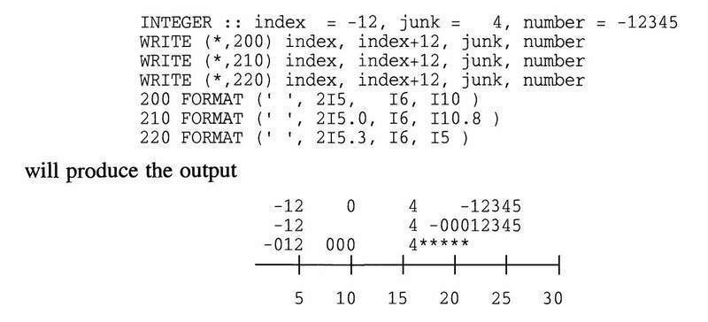

Hi
I am learning fortran from Chapman's "fortran 90-95 for scientists and engineers". I have question about the I descriptor. In the attached image, look at the second format statement, 210 format. In the output, the variable index+12 is not printed. I don't understand that. The book says that the I descriptor has general form rIw.m where m is the minimum number of digits to be displayed. So in the statement 210 format, we have 2I5.0, which means that minimum number of digits to be displayed is zero , but then in the output we see that "index" is displayed , while "index+12" is not displayed. I don't understand this confusing behavior.
thanks

The minimum number of digits needed to represent 0 (in fortran) is zero, so the blank is acceptable.
I don't quite follow, antiphon. In that case, why is the variable "index" is displayed when that is also given the same descriptor.
I think it's due to the index being negative that it gets displayed. It's a kinda gotcha that teachers want you to remember. Practicing programmers tend not to use these kinds of formatting because of this behavior. Basically if I'm printing a number I want to see a number.

well jedi, that's not true. I changed index to 12 and with descriptor [itex]2I5.0[/itex] , the values now printed are 12 for index and 24 for index+12.
Okay so the best answer is that if it's zero then nothing is printed. It might be a hidden feature where you're generating a report and when a row value is zero then print nothing.
I5 means use 5 columns and right justify the number ie like I5.1
whereas I5.0 means use 5 columns and print the number right justified with a minimum of zero digits which means 1-9 prints as one digit but zero prints as zero digits.
And I5.2 would print 1-9 as ___01 ___02 ... And zero as ___00. With underscore as space
Anyway, just remember this for your test, that's why it's given to you.
When you use Ix.y, y is the MINIMUM number of non-blank characters that will be used to display the number.
If the "conventional" display of the number would take LESS than y characters, it is padded with 0's to produce output like 00012 or -0012.
If the number takes MORE than y characters to display, then more than y characters are used (up to a maximum of x characters, of course)
The only practical reason for using a Ix.0 format is if you want a field that would contain zero to be left completely blank. In "real life", you would almost always just use an Ix format, and get zero values printed as 0.
