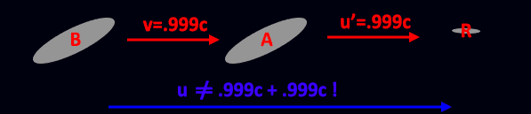

Let's say your on a planet thats in a galaxy flying through space at 99.9% c. To you, you perceive you are at rest. Now let's say you point in the direction of the galaxy's motion and blast off in a rocket, and try to accelerate to 99.99% c within your frame. If your planet is already flying through space at 99.9% c unbeknownst to you, how can you accelerate at all?

You cannot say the galaxy "A" is flying through space at any speed, let alone, 99.9%c.
Velocity is relative. Best you can say it that galaxy A is moving relative to some other coordinate (such as another galaxy, B).
As far as galaxy A, is concerned, it - and everything in it - is stationary, and galaxy B is moving relative to it at 99.9% c.
No problem. You started at rest, so now your spaceship is moving away from galaxy A at 99.9%c.
Here is the tricky bit: the question you want to ask is: how fast is the rocket moving away relative to galaxy B (which sees galaxy A receding at 99.9% c away from it)?
You do not add velocities simplistically in relativity. You do not simply add .999c and .999c together.
This is the formula for relativistic velocity addition:
If you set
v=0.999c and u'=0.999c
u will be 0.999999499
No matter how close your numbers are to c, the result will always be less than c.
(Try it!)
0.999999499c is how fast the rocket - leaving galaxy A - will be observed to be moving - from the frame of reference of galaxy B.
Digest that a bit, and we can get into specifics.

Awesome thank you for answering this. Ok I think I understand. Let me see if I have this right.
So from a person on the planet in galaxy A at the spaceport watching the rocket blast off, he will see the rocket accelerate away from the planet starting at 0mph and accelerate normally up to .99%c. For the person in the rocket, he will see the same, though galaxy b appears to be traveling in the opposite direction past his solar system at .99% c and as he accelerates the galaxy keeps pushing towards the absolute limit close to 100%c.
For the person in galaxy b, he sees the planet in galaxy a flying by at .99%c. The clocks on galaxy a appear to tick nearly infinitely slowly, so even though the person in the rocket sees his speed change from 0mph to .99%c, galaxy h sees him and that change in velocity is so small because time and space are slowed and compresed relative to galaxy b...i think that's right right?
The confusing part is that person a appears to see a delta in V of ~400k mp/s, and person b sees the delta v as .00000001%c. But I guess its the per second part time dilation that preserves both perspectives reality...
Likes DaveC426913
Yep. You pretty much got it.BTW, be careful with your numbers.
.99%c is less than one per cent of c.
You want either 99%c or .99c, not both. (Convention prefers the latter.)
