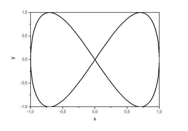

The two linear simple harmonic motions of equal amplitudes , and angular frequencies ω and 2ω are imposed on a particle along the axes of X and Y respectively. If the initial phase difference between them is π/2 , then find the resultant path followed by the particle.
http://en.wikipedia.org/wiki/Simple_harmonic_motion
I tried solving question using x= a sinωt
And other is y=a sin(2ωt + π/2)
Solving them , I get the wrong answer in terms of x and y...
Please help !
Thanks in advance...

Firstly I solved this question using :
a : Amplitude
x=a cosωt
y=a sin(2ωt+π/2)
y=a cos (2ωt)
y= a( cos2ωt-sin2ωt)
y= a(2cos2ωt-1)
y= a{(2x2/a2)-1)
I noticed that this does not match the answer given in my textbook...
Then I made a second attempt :
x=a sinωt
y=a sin (2ωt+π/2)
y=a cos(2ωt)
y= a(1-2sin2ωt)
y= a{1-(2x2/a2)}
Again this does also not match with the answer in my textbook...
Then I made the third attempt :
x= a cosωt
y= a cos(2ωt+π/2)
y= -asin(2ωt)
y= -2a sin(ωt)cos(ωt)
y=-2a √(1-sin2ωt) (x/a)
y=-2a √{1-(x2/a2)} (x/a)
On squaring both sides and simplifying , I got :
y= 4x2{1-(x2/a2)}
This answer matched with the answer given in my textbook...
I just wanted to know , where I went wrong in my first and second attempt...

Your first attempt was
x=a cosωt
y=a sin(2ωt+π/2) which is equivalent to
y=a cos (2ωt)I do not see any initial phase difference between x and y.
Your second attempt is true and so is the third one. Phase difference between x and y is not a clear concept. You get x,y curves of different form if x=sin(ωt), y=cos(2ωt) (y=1-2x2) and when x=cos(ωt) and y=sin(2ωt) (y2=4x2(1-x2))
ehild
