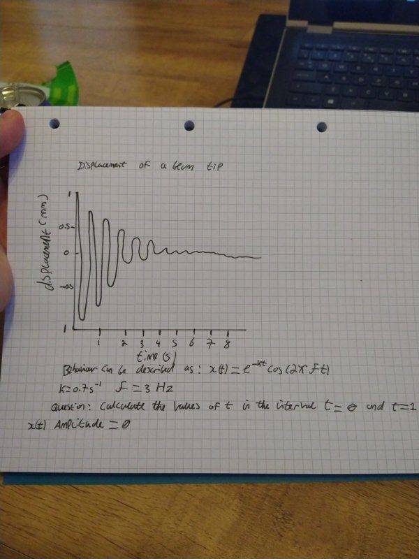

x(t)=e^-kt cos(2πft)
Hi guys sorry if this is the wrong thread,
I have a damped simple harmonic motion pictured below, i have to find the inerval t=0 and t=1 for which the amplitude of x(t) is considered to be zero.
The behaviour of the graph below can be described as e^-kt cos(2πft)
k=0.7s^-1 and f= 3Hz
I don't really understand the question, what makes more sense to me is to compute the values ##t_0## and ##t_1## that are the two smallest positive solutions to the equation $$x(t)=0$$ is this your question?

Not really man, as, i guessed that would be zero.

Then, could you please explain to me what is exactly the question? I'm sorry, but I don't understand the question you post in #1.
The use of "amplitude " in the question may be misleading. In terms of the expression ##e^{-kt}\cos(2\pi ft)##, the amplitude is ##e^{-kt}##. This is never actually zero. I suggest the intended question is to find when the displacement x(t) is zero.
