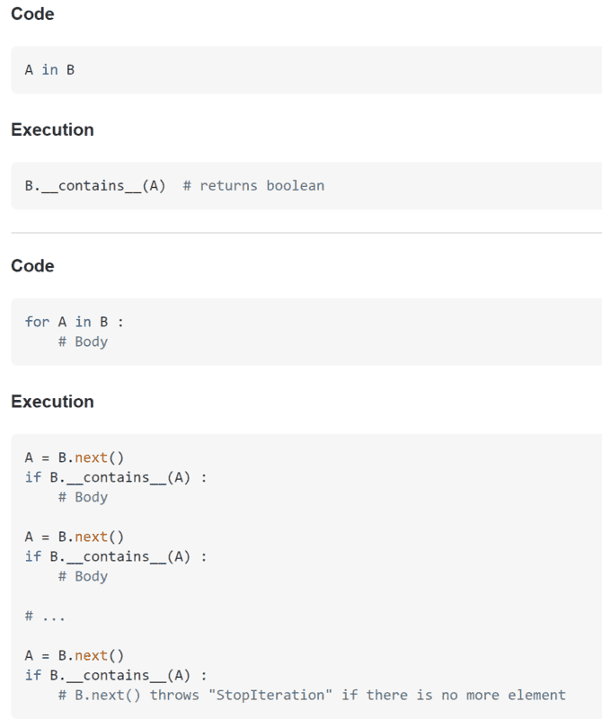

fog37 said:
This is from wikipedia describing how a for loop has an initialization as well as a condition
Which Wikipedia article is this? I can't find the text in your images in the article about the "for loop"
https://en.wikipedia.org/wiki/For_loop
As far as the meaning of the membership operator in, the operator in performs membership testing in different ways for if and for structures.
https://stackoverflow.com/questions/54124354/python-in-operator-with-for-loop-and-with-if-statement
In the case of the for loop, both next() and the method __contain__ are called.
In the case of an if statement, only the method __contain__ iscalled when in is implemented.
No, you're over thinking this. The for loop as a whole executes its body repeatedly with the variable bound to successive elements of the iterable. The "in" in "for var in iterable:" is not an operator that "does" anything in this context. It is just part of the Python syntax of a for loop.
Elsewhere, in expressions, in is a binary operator that returns True if the first operand is contained in the second and False if it isn't. It is not limited to being used only in if statements. For example,
Python:
print(3 in [1,2,4])
prints "False".
Wrong. I have no idea where you are getting this from, but it certainly isn't from any knowledge about how the Python interpreter actually works.
Fortunately, Python makes it easy to test how the interpreter actually works. Consider the following:
Python:
>>> class TestContainer(object):
...     def __init__(self, items):
...         self.items = items
...         self.iterator = None
...     def __iter__(self):
...         self.iterator = iter(self.items)
...         return self
...     def __next__(self):
...         try:
...             return next(self.iterator)
...         except TypeError:
...             raise StopIteration
...         except StopIteration:
...             raise
>>> test = TestContainer([1, 2, 3])
>>> for item in test:
...     print(item)
>>> 1 in test
True
>>> 0 in test
False
>>> class TestContainer1(TestContainer):
...     def __contains__(self, item):
...         raise NotImplementedError
>>> test1 = TestContainer1([1, 2, 3])
>>> for item in test1:
...     print(item)
>>> 1 in test1
Traceback (most recent call last):
  File "<stdin>", line 1, in <module>
  File "<stdin>", line 3, in __contains__
NotImplementedError
>>> 0 in test1
NotImplementedError
This code shows several things:
(1) A for loop never calls the __contains__ method on an object; that method doesn't exist at all for the first test container, and raises NotImplementedError for the second, and the for loop works fine in both cases.
(2) The "in" keyword in an if statement does call the __contains__ method on an object, if that method exists; that's why NotImplementedError gets raised for both if statements on the second container.
(3) If the __contains__ method does not exist on an object, the "in" keyword in an if statement still works and returns proper results, as shown in the if statements on the first container. How does that work? Well, under the hood, the Python interpreter, if it can't find a __contains__ method on an object, sees if it can iterate over the object; if it can, it does so, and looks to see if any of the values produced are the one it is looking for. That's what is happening with the if statements on the first container.
Exercise for the reader: could you add print statements to the above code to explicitly test my claim in #3 above? That is, to explicitly test that the __iter__ and __next__ methods on the container get called when an if statement with the "in" operator is used and no __contains__ method is present?

But the for loop always must have the "for...in" structure.
Case closed :)
