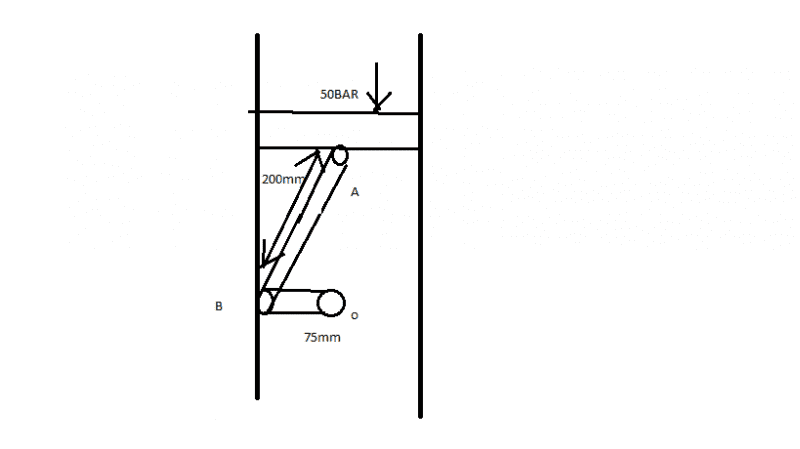

A cylinder in a truck engine are shown in
Figure Q8.1 below. The piston slides without friction in the cylinder of diameter
150 mm. The combustion chamber is subjected to an internal pressure of
50 bar gauge as a result of fuel combustion without any leakage past the piston.
The connecting rod AB has a length of 200 mm. It is linked to the piston at A
and to the crank-shaft at B. The crank-shaft OB has a revolution radius of
75 mm
1 - Calculate the resulting instantaneous force on the piston if downward force is 80kN about the crankshaft axis of rotation O..
2 - Calculate the angle OAB.
3 - Calculate the projection of the force transmitted by the piston to connecting rod AB.
4 - Isolate crank pin OB and calculate the moment resulting from the force transmitted by connecting rod AB.
Consider an anti-clockwise rotation as positive.
5 - Calculate the rotational velocity of the engine crankshaft if engine is running at 1500rpm.
6 - What is the crankshaft power output of a 6 cylinder engine at this running
condition if the average torque produced on the crankshaft at a certain
engine load in one cylinder at 1500 rpm is 170 Nm?
Please find diagram below.
Are these answers right?[/B]

The first question is:
Calculate the resulting force on the piston from the pressure in the
combustion chamber.
So was what I did for this and the following question right?
So on the first one you do not need to assume downwards force is 80kN, but on the second question onwards you do.
So if it's from the pressure I believe I have done it correctly.

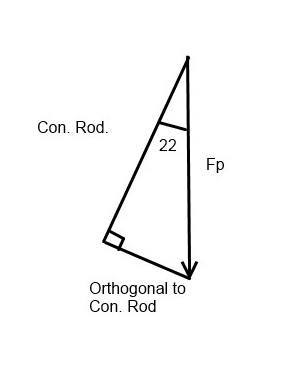

Q3 - Calculate the projection of the force transmitted by the piston to connecting rod AB.
A3 - Force on AB = 80,000/cos(22) = 86,282.8N

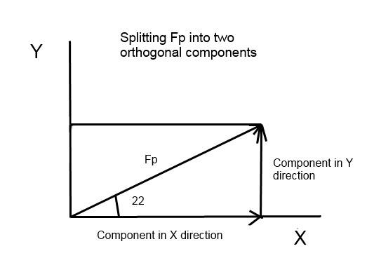

I don't think that's correct. If the force from the piston is FP acting vertically then the force acting in the direction of the crank is
FpCos(22)

Thank you for the help! Why is it cos(22)? isn't the force downwards the adjacent, because it looked like the connecting rod AB would be the hypotenuse?
When you resolve a force (eg FP) into two components the components need to be at right angles or they aren't independent of each other. (If they aren't orthogonal then one component would itself have a component in the direction of the other.)
In this problem we want one of the components to be in the direction of the con rod so the other will be at right angles to the con rod. If you draw that you get this..
Cos(22) = Fconrod/Fp
or
Fconrod = FpCos(22)

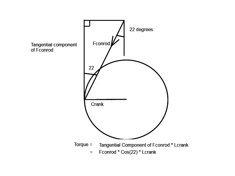

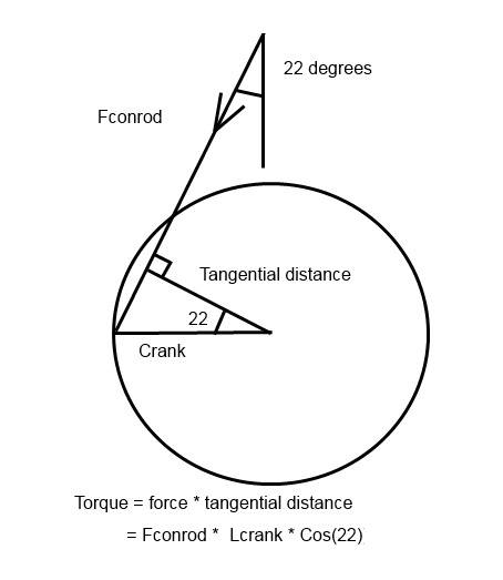

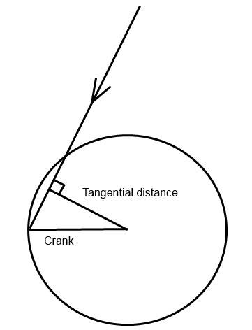

I'm getting really confused with the question numbers. In the original post Q4 says...
That's asking you to calculate the moment/torque that the con rod gives the crankshaft. For that see the diagram in post #12.
Torque = Fconrod * tangential distance
From above
Fconrod = FpCos(22)
From the diagram in #12..
Tangential distance = LcrankCos(22)
So
Torque = FpCos(22) * LcrankCos(22)
=Fp*LcrankCos(22)2
Fp is either 88,350N (if you calculate it from the pressure) or 80,000N (if you use the value the question tells you to assume). Hopefully your tutor will clarify that issue.

Then for question involving the diagram you just sent, why is it a right angle between the connecting rod and crank shaft? because it makes sense how that is the hypotenuse in that case but in the diagram it is perpendicular to the cylinder walls.
If you mean this diagram..
It's not a right angle between the connecting rod and crank. The crank is horizontal in my diagram. Take a look at how torque is calculated. Only the tangential component of the force contributes to torque.
There are two ways to work that out but both give the same answer. In the first you work out the effective length of the crank (the tangential distance) in the second you work out the component of the force that is tangential to the crank. Both methods give the same answer... but perhaps the second is easier to understand?
So step by step starting from the top of the engine...
Vertical force from piston is..
Fp = 80kN (we are told it's 80kN but it calculates to 88,350 N)
The force in the conrod is..
Fconrod = Fp * Cos(22)
The torque on the crank is..
Tcrank = Fconrod * Cos(22) * Lcrank
Substituting you get..
Tcrank = Fp * Lcrank * Cos(22)2
Edit|; I make it 5158NM if Fp = 80,000N or 5696NM if Fp = 88,350N

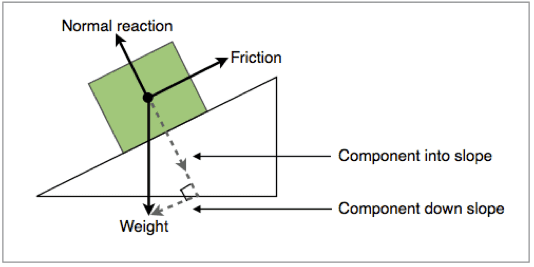

The one thing I'm still having trouble comprehending is why it is Fp*Cos(22), because i can't see why the Fp is the hypotenuse of this triangle
Just posted all my answers to the test, got 80% but it wouldn't let me see which answers I got wrong.
The one thing I'm still having trouble comprehending is why it is Fp*Cos(22), because i can't see why the Fp is the hypotenuse of this triangle.
Have you covered blocks on a slope yet? See...
Gravity acts downwards = mg
The component normal to the slope (into the slope) = mg*Cos(angle)
The component parallel to/down the slope = mg*Sin(angle)
The component normal or into the slope) is equivalent to the component in the direction of the conrod.
edit: If you have done the tip-to-tail method of adding vectors then perhaps you can see how the two orthogonal components add together to equal the weight vector. If they weren't orthogonal (at right angles) one component would itself have components in the direction of the other.
edit2: The very word "component" means "part of" so the component is smaller than the whole vector.
I have covered that before, but why is that the component in the direction of the conrod? the force here, mg is still the hypotenuse of the triangle right? and isn't the force down the conrod the hypotenuse?
Correct.
No. The hypotenuse is larger than the other sides of the triangle. How can a component be greater than the whole?
It's possible you are confusing the mechanical geometry (where the con rod does look like the hypotenuse) with a vector component diagram where it isn't.
Consider this diagram..
I have marked a vector Fp and shown it's components in the X and Y directions. Does that make sense?
If that makes sense print it out and rotate it clockwise until Fp points downwards. The component in the X direction should now point in the direction of the conrod.
