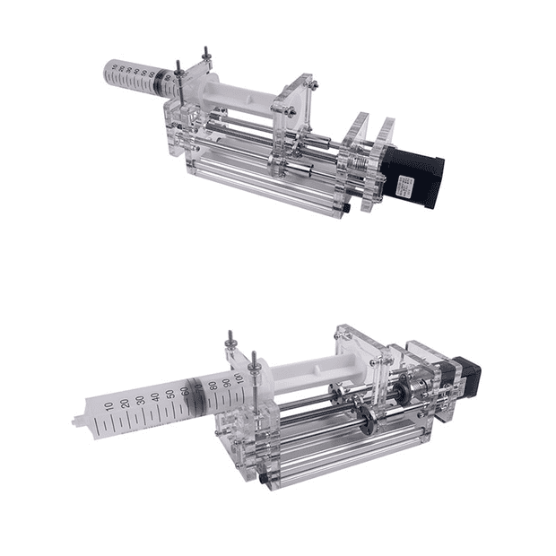

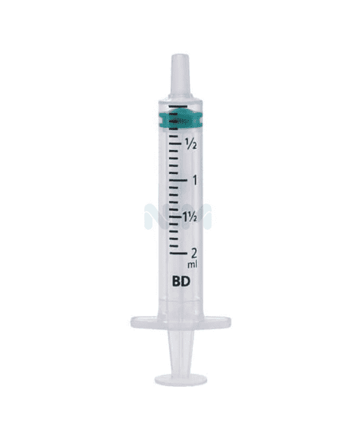

Here: I had in mind a system similar to this but on a smaller scale, for example suitable for a 2ml commercial micro syringe without a needle:
The piston could be a part of the "cap" of the glass flask, while the syringe must be a disposable component, easily to replace.

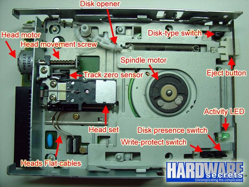

If it's not some thick, viscous liquid and on the level of a DIY project then just grab an old floppy disk drive head servo o0)
It comes with a quite convenient interface/electronics too.
It is mainly an aqueos solution... so the viscosity should be comparable with the water...
Nice idea! I guess it could be a pain to find a new floppy disk driver in the 2023 :cool:
I have to see in my ceiling... but, exactly: which part did you have in mind? Head motor + movement screw? If I remember right, power requirements were quite high respect the low power consumption needed here with a battery...

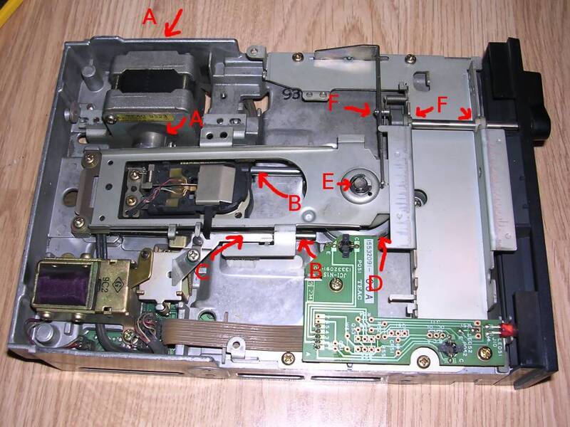

Yes, but you need an even older, 5.25 sized one, which still has a decent stepper and two rails to aid the movement:
(source)
The smaller, 3.5 inch ones just won't have the power.
Honestly, on second thought I'm not sure about the old ones either. But ... well, it feelt like a good idea at that time :wink:
