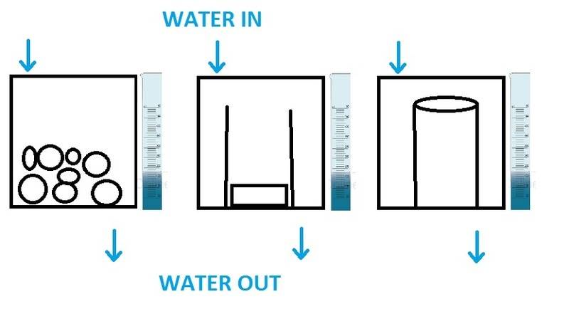

Hi, here's a quick brain teaser, if we have 3 objects in sealed boxes, we know what the objects could be: a solid metal cylinder, a metal sphere, mixed shape beads, a beaker with a metal object in it, a pyramid.
We can pour water into the boxes and measure the relative liquid height between boxes.
So how would you determine which object was in each box?
Has anyone done this experiment before?

1. the objects could be any shape, but there is a list of possibilities, the ones given were just a few examples
2. the water goes either outside or inside the beaker, the beaker could be anywhere in the box, under the water inlet or not
3. the tap at the bottom of the box is closed, and the volume of liquid measured changes as you fill the boxes. the water can be emptied at any point by opening the tap at the bottom.
4. Yes, I believe that is the theory, to watch the water level and how it behaves, for example if it rises quickly there is a large object in the box. If it rises slowly, there is a small object, if it doesn't rise at all until a certain point then it is going into a beaker first etc etc
I just wondered if there is a way to quantify this? i.e. knowing the equations for volume of the objects
Other than that I will have to simply have the students watch how the volume level of the water rises.
You can compute the volume unoccupied by the objects for horizontal slices, which tells you how fast the water level rises at the height of each slice.
But there are tricky cases: The entire beaker interior belongs to the slice at the top of the beaker: Big slow down in level rise at this point, easy to spot.
I'm assuming the objects don't float.

Unfortunately there are some different sized hollow balls that do float.
rwooduk said:
Good idea! Thanks for that.
While all the objects inside float, the level rises at a constant rate that is equal to the fill rate. The offset between the filled in water volume, and what the level says is determined by the weight of the floating objects.
However there are transition phases at the begin (nor floating yet) and the end (ceiling contact). If you have too many objects, they might not float freely for long.
