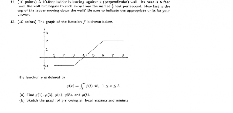

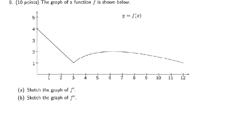

I figured out #11, could use help with the other questions. I have a final tomorrow in the morning and my professor gave us a few questions to try out so help would be appreciated. For #8 I'm not sure how to draw the second derivative graph, for #12 I don't know where to begin, and for #15 I don't know how to find the anti derivative of f'(x) so I can't start the problem. Help is appreciated
For 8 to draw f'(x) you need to see where the slopes are increasing, decreasing or remaining constant. From 0 to 3, you can see the slope is constant. From 3 to 6-7ish the slopes are increasing and from 7 on the slope is decreasing. You can draw a graph based on the knowledge I just told you. Do the same to that graph to get the 2nd derivative graph.
That's what I pretty much thought, thanks for the reasurement. The only one I really don't got a clue on is #12, so if someone could explain that for me that'd be great.
For 8) once you draw the derivative f '(x) then just draw the derivative of that graph to find f ''(x).
For 12) remember that you can split an integral up into sections, for example,
\int _ 1 ^5 f(x)dx = \int _ 1 ^2 f(x)dx + \int _2 ^ 4 f(x)dx + \int _4 ^5 f(x)dx
so you should do the same, choosing your sections based on the changing slope of the graph of f.

So for #12, the answer for g(1) would be -1 because the slope is -1, the anti derivative of that is -x and just plug in 1 and you get the answer? Also how would you find the answer for something like g(3) where the point is between the changing slopes.
I'm kind of lost on #15 now, will give a try though. Thanks for the help.
No. g(1) ≠ -1 .
If ##\displaystyle \ g(x)=\int_{1}^{x}f(x)\,dx\,,\ ## then ##\displaystyle \ g(1)=\int_{1}^{1}f(x)\,dx\ .\ ##
Think of the definite integral as the area under the curve -- or the negative of the area above the curve.
SammyS said:
No. g(1) ≠ -1 .
ok i think i got it. so i don't really even need to take the antiderivative..just look at the graph and calculate area. g(1) = 0
