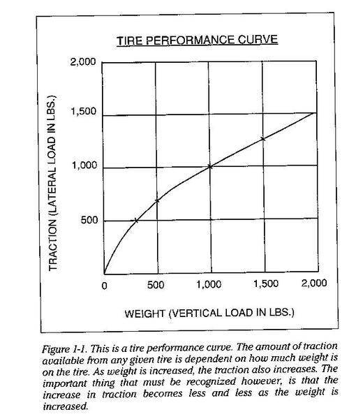

Tire traction- realize the more load placed on a tire, the more traction ..but...the tires coefficient of friction decrease. However, up to the design limit of the tire, its traction capacity ( ability to actually transmit force to the road) as opposed to dimensionless coefficient of friction, increases with vertical load.
simplified - vertical load on a given tire increases, the area of the rolling contact patch remains virtually constant, and so the unit pressure of the footprint increases. As the unit loading rises, the rubber has less resistance to frictional shearing and so the coefficient decreases. However, the curve is so gentle , if you graphed this, that the increase in vertical load overpowers the decrease in coefficient of friction.

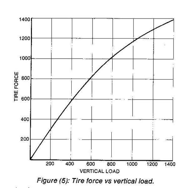

Our Can Am car with total rear wheel load of 1080 lbs. CG of 13 inches, rear track width of 60 inches cornering at 1.4 G
load transfer= (1.4) x 1080 lbs) x (13") / (60") = 328 lbs.
this means under steady state conditions, 328 lbs. of the load of the inside rear tire would be transferred to the outside rear tire giving resultant inside read tire load of 212 lbs. and outside tire load of 868 lbs. We have transferred 61 % of the inside tire vertical load to the outside tire. This is not good. See chart below. We find that we reduced the cornering force of the pair of rear tires from 1512 lbs. to 1400 lbs.
The only way to decrease the magnitude of the lateral transfer for a given lateral acceleration is to decrease the vehicle weight, increase rear track width or lower the center of gravity.

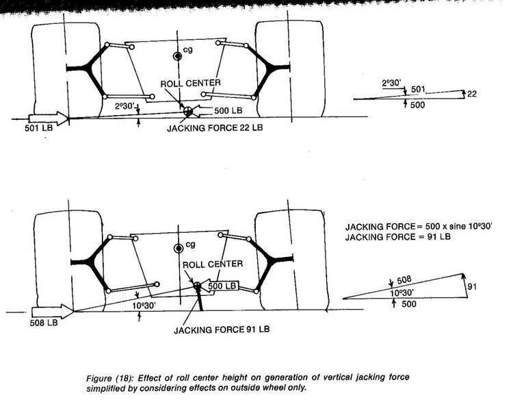

Swing Axle Jack - Any one who raced a VW will tell you t he car " jacks itself up" when going around a corner. It is the effect caused by the fact that the reaction force at the tire which balances the centrifugal force of the turn must arc through the ROLL CENTER.If the roll center is above the ground, then the line of action between the tire contact patch and the roll center will be inclined upward toward the vehicle centerline. This being so, the side force developed by the tire will have a vertical component which will tend to lift or " Jack' the unsprung mass. This lifting action, in addition to raising the CG will also move the suspension into droop with tire camber going the wrong way. Bad news.
The higher the roll center ( or narrower the track) the steeper the inclination of the line of action and the greater the jacking force.
