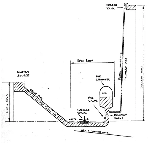

Yes. Water is effectively not compressible, when compared to the elasticity of a steel pipe. If the reverse was true, the ram pump could not function.
Ram pumps are easier to understand and work with, if you make the wise assumption that water is incompressible. What is unfortunately elastic, are the pipes, which explains why the twelve or so meters of fixed diameter induction pipe, closest to the pump must be made from a metal such as steel, not from plastic. The remaining upstream part of the induction pipe can be made from cheap and flexible "polypipe" without problems. The steel pipe ensures that a significant pressure pulse is generated and maintained, which will only very slightly expand the elastic steel pipe.
The steel pipe must withstand the water hammer pulse when the waste valve slams shut. That pressure wave travels away from the waste valve, pushing a small amount of water through the check valve, into the bottom of the air reservoir and outlet chamber, as it passes, on its way back up the induction pipe.
The pressure wave generated by the waste valve closing, moves upstream through the induction pipe to the inlet, where it is inverted by the reflection from the open-ended induction pipe, to become a depression wave that runs back down to reopen the waste valve for the next cycle. There is a convenient complication here, in that the pressure inversion due to reflection, may be from the junction between the steel and the plastic induction pipes, since the significantly greater elasticity of the plastic can appear to be an open-end. The same inversion may be obtained from a step increase in pipe diameter at that junction.
The check valve below the air reservoir prevents the pumped head from affecting the lower pressure at the waste valve due to the lower head of water in the induction pipe. The water outlet line from the bottom of the air chamber can be small in diameter, and several kilometres long. That is because the flow through the outlet line is steady, driven continuously by air pressure, and so the flow does not pulse.
There must be air in the chamber to continuously oppose the outlet head, but that air also allows the check valve to operate. It is sometimes necessary to induce a few small bubbles of air into the pump body, to maintain sufficient air in the outlet chamber. Excess air will be vented, through the outlet line as compressed bubbles in the water. The air chamber pressure and volume is therefor self-regulating.
