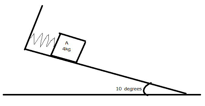

The spring in the figure below is initially compressed by 0.4 m in the position shown. If released from this position, block A travels 0.9 m before coming to a stop. The kinetic coefficient of friction is 0.8. What is the spring constant? (The spring is not fastened to block A)
Elastic potential energy=0.5kx^2
Work=Fd
The force of gravity acting on the block=9.81*4=39.24 N
The force of gravity acting on the block parallel to the ramp=sin(10°)*39.24=6.81 N
The force of gravity acting on the block perpendicular to the ramp=cos(10°)*39.2=38.64 N, which is also what the normal force is equal to.
Force of friction=38.64*0.8=30.91 N
Elastic potential energy=(0.5)(0.4)^2(k)
The block will gain kinetic energy from the elastic potential energy + the gravitational potential energy, and lose an amount equal to that (since it stops) due to friction, so:
elastic potential energy+gravitational potential energy=energy lost to friction
(0.5)(0.4)^2(k)+(6.81)(0.9)=(30.91)(0.9)
k≈271
However, the answer I'm given is k=260. I'm not sure if this is a typo, rounding error, or if I'm doing something wrong. Any help would be much appreciated.
You're very close. Your mistake is in the gravitational potential energy. You are told that it travels 0.9 m along the surface; so is the block initially 0.9m vertically above the final state, or is it a different amount?

I found the gravitational energy by multiplying the amount of gravitational force acting parallel to the ramp (6.81 N) by the distance it acts for:
≈(6.81)(0.9)
≈6.129 J
Using the gravitational potential energy equation, I get the same answer:
=mgh
=(4)(9.81)(sin(10)*0.9)
≈6.13 J

My apologies. I saw no sin(10) in the last line and assumed you had overlooked it. The work looks correct to me otherwise.
