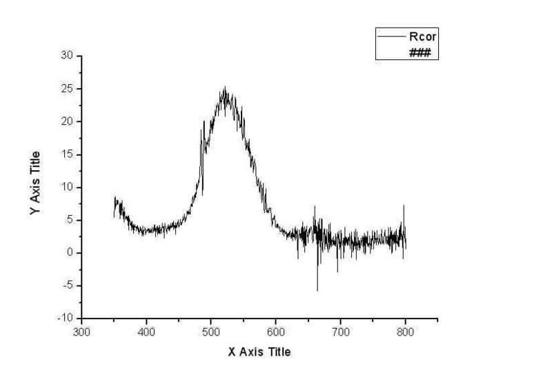

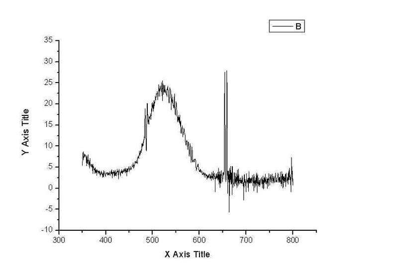

Dear PH,
Recently I have been trying to determine if a surface is iridescence or not. The most quantitative method to achieve this is to find the maximum reflective peak, this is also highly repeatable and worked well.
The idea is to move a sample at all angles of possible viewing geometry and find the maximum reflection peak and that measurement (nm) is the so called colour! This is accepted in biological systems, the field I am working in.
Having measured the surface I found the data to have a very sharp peak where I can clearly see there shouldn't be one. You can see in the attached file there are two peaks that I believe should not be there as I can see that there is no represented colour on the surface no matter what angle. The peaks that are 'weird' are at 490nm and 660nm. The integration time for the Spectrophotometer was at 100, the average scans at 5 and the Box CAr Width was also at 5.
My question is this, is there any known reason why I should be getting these random peaks? Could it be the intergration time, something I don't fully understand anyway or could it be something to do with iridescence as a phenomenon?
Thank you in advance and kind regards
Sam

Those sharp peaks are artifacts. Ozone and water vapour in the atmosphere have sharp peaks in that range of wavelengths. The spectrometer output is the ratio of detected intensity with and without the sample. Because of the sample, the light travels different length as without the sample, and also some reflected radiation also reaches the detector: so these peaks do not quite cancel. Just ignore them. ehild

Try to change the measuring parameters. Slower scan, longer integration time, lower resolution. I do not know what your data are as you did not give the units. Your spectra look very noisy.
ehild

I would try to average more spectra, say 20 or so, to decrease the noise.
I think you use a small diaphragm for the incident light when taking the reflectance?
Anyway, the spectral range should not exceed 350-800 nm. The artifacts can be cut out from the spectrum. Or you can cheat a bit, replacing the reflectance data with more reliable ones.
With your data processing program, Excel or Origin, you can also smooth out the noise by "adjacent averaging".
See attached spectra. The first is is the original one, the second is the one where I replaced the impossible data with some value in range, and the third is the smoothed one. I used Origin.
ehild
