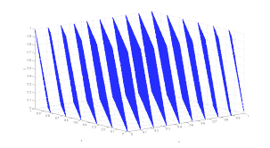

You may be remembering (or misrembering) RANDU.
Anyway, "large and odd" may well be unnecessary, but it sure doesn't hurt anything.
Yes. That was it. I didn't want to name it because I am not sure that modern versions with the same name still have that problem.
Nice, that's probably what my friend was referring to when he told me this story in 1975-76 before he retired from GE.
He was the resident math library programmer for the GE computing center and he did his work in Fortran IV and Honeywell Fortran-Y a precursor to Fortran-77.
Although I was under the impression it was a single plane, multiple planes make more sense.
https://en.wikipedia.org/wiki/RANDU

FactChecker said:
Its flaws were unlikely to be significant in anything except academic exercises.

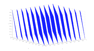

I disagree. It's fine in 1D and 2D, but if you are "randomly"picking points or directions in 3D space, you don't have complete coverage. Of course, this is only a problem if you live in a universe with three spatial dimensions.
"Complete coverage" is rarely achieved in a Monte Carlo simulation. The nature of the imperfections that you are pointing out is no greater than many Monte Carlo simulations with a limited number of samples. I have personally never been suspicious of the random number generator results except in academic examples where time series analysis was applied. I admit that there are disciplines where it is critical, but they are far fewer than the "universe with three spatial dimensions". In fact, many Monte Carlo simulations have hundreds, even thousands, of dimensions, and approaching full coverage is completely impractical.
Vanadium 50 said:
I would pick large odd numbers. This is a little bit "lore", and certainly doesn't apply to many RNGs. For example, if x is your sequence number 10x + 1 + 1000000 might be a better way to do it.
I think for my application, I don't need to worry too much about these issues with patterns in the random numbers as some of you suggested, but I don't see any reason not to be safe and use an approach like this instead.
If you want a random distribution that uniformly populates x, y and z, I would say that this
is not it.
is not it.
That is a good point. I doubt that any of the standard library random number generators use that any more.
