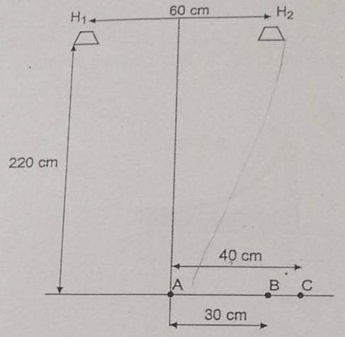

1.
Two speakers emit sound in phase with the frequency of 13.2 kHz, the sound from the loudspeakers directed at points A , B and C. Rank the volume of the three points with the weakest first.
speed of sound 340m/s
2.
3.
I think I need to use Pythagoras says to calculate the
path difference from H1 TO A. This is what i have done but I am sure it's wrong.
60^2+220^2=52000 root square of (52000)= (20) root square (130). I don't really know what I am doing my self.

You wrote H1 to A, but in fact calculated H1 to B, right? That's fine. You mentioned a path difference, so you need another path length. What two path lengths do you need to compare to find what happens at B?

For each point, you need to know the phase difference for the two speakers sending the sound to the point. To calculate the phase difference, you need the two distances (from each speaker to a point), and you need the wavelength of the sound. Does that help?
Can you write the 6 distances (two for each point)? And what is the wavelength of that frequency in air?

Let's start with point B. Can you work out the distances from H1 to B and from H2 to B?
H1-B:
When I sketch , I get a triangle , then I can use the Pythagorean theorem . So i get 60^2+220^2=52000 root square of (52000)= (20) root square (130)But if i calculate the first max with the grating equation, will i get the answer?

Not yet. You need H2-B as well.

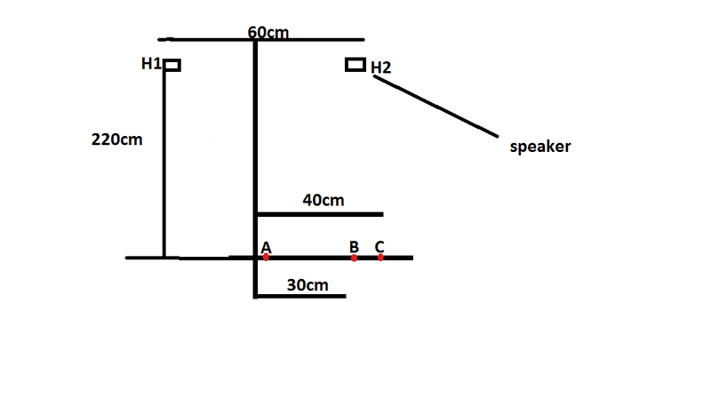

H2-B: 60+40=100, 100^2+220^2=58400 root square of 58000= (20) root square of (146)= 214 is that even right?
Here is a better picture:

How do you get 60+40?

We want the distance from H2 to B. Draw a straight line connecting them on your diagram.

I need to label some more points in your diagram for reference.
Call the point half way between H1 and H2 the point O. This is 30cm from each of H1 and H2, right.
What shape do the four points O, H2, B, A make?

Right. How long is the side H2-B?

You have.the rectangle O-H2-B-A. According to the diagram, what are its dimensions?

Oh is H2 to B 220cm??
Yes.
So what is the difference in length between H1-B and H2-B?
