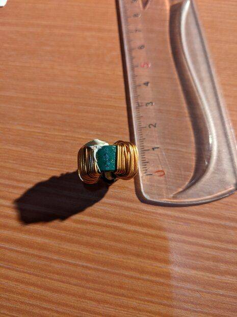

I'd like to know the maximun value of current that can go through my coil
Hello!
I've obtained common mode choke from detached pieces, so I don't know anything about them, exept for their inductance/resistance.
I'd like to know how could I determine the rated current of these coilsthank you in advance for your help

The current rating will depend on the saturation flux of the cores. Do you have any datasheet on the cores, or even know what material they are made out of? What is the frequency range where you want this CM choke to work? What is the level of DM excitation?

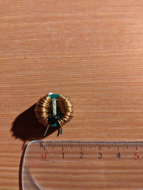

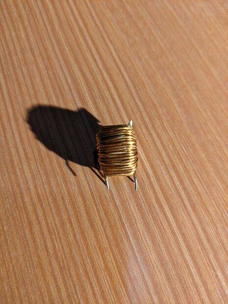

Yes, Differential Mode versus Common Mode. Anything that creates a flux in the core can saturate it. What size are they physically? How many turns? (pictures?)
What current levels are you anticipating? What level of CM impedance do you need in your application?
Common mode current will be created with a step-down chopper powered with 15V and from what I've read, we can expect a peak at 0.1 A. The coil has around 30 windings.
Here's some pictures (the ruler is graduated in centimeters)
