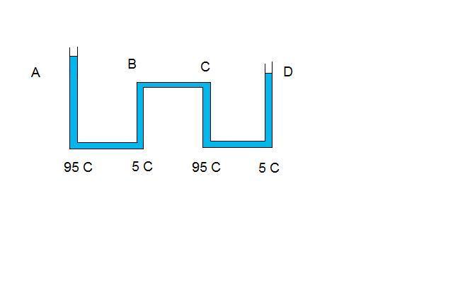

The apparatus shown consists of four glass columns connected by horizontal sections. The height of 2 central columns B and C are 49 cm each. The height of the liquid in A and D is 52.8cm and 51 cm resp (measured from the baseline). The water columns are maintained at temperatures indicated. What is the ratio of density of liquid at 95 C to that at 5 C?
Pressure at the bottom of A should be equal to the pressure at the bottom of D as they both are on the same horizontal level.

Abdul Quadeer said:
… What is the ratio of density of liquid at 95 C to that at 5 C?
Yes. :smile:
So what is the ratio of the densities?
Thanks a lot for looking into this unanswered thread.
ρ1 x g x 52.8 = ρ2 x g x 51
ρ1/ρ2 = 51/52.8 = 0.9659
where ρ1 = density at 95C
Unfortunately, this answer is incorrect :(
Where do you think I am wrong?

Sooo :-p … there are 3 ways of doing this …
i] Use good ol' https://www.physicsforums.com/library.php?do=view_item&itemid=26" on each of the four columns … call the upward forces at the bottom of the two left columns T1, the upward forces at the bottom of the two right columns T2, and the downward force at the top of the two middle columns T3.
ii] calculate total gravitational https://www.physicsforums.com/library.php?do=view_item&itemid=269" for a fixed total length for each height difference, and see which one is the lowest!
iii] use Bernoulli's equation anyway, but with a correction term ∑(∆ρ)(∆h) for each of the two pairs of boundaries across column B and column C.
… try anyone of them, and see what you get! :smile:
(or, preferably, try all three! :wink:)​

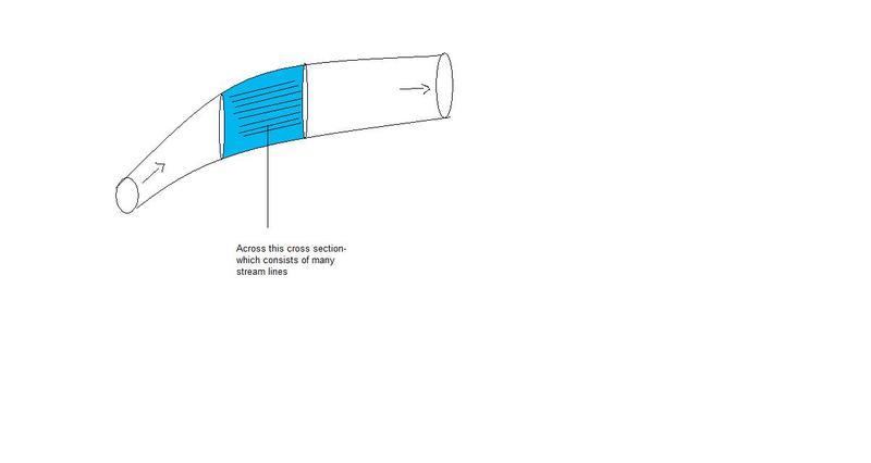

I was talking about this-
Diagram of a curved pipe with arrows showing flow from left to right, with a shaded blue cross section near the middle labelled: Across this cross section- which consists of many stream lines.
A cross-section would usually be drawn very thin, not long like that.

I am getting the answer as 100/101.8 which is exact!
While doing the problem, I figured out a shorter method-
If we consider the horizontal section BC, the gauge pressure should be equal as the liquid is stationary.
i.e. Patm + Pa - Pb = Patm + Pd - Pc
If you solve the equation, you get the same answer!
I think this is more shorter. I would fail in my duty if I don't thank to you - I figured this out only after your help :smile:
