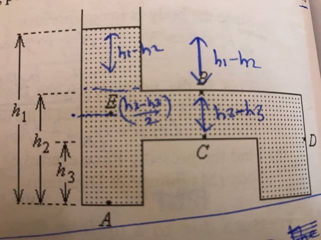

a)Consider the vessel in the figure shown. It contains a liquid of density p. Calculate the pressure, and give the direction of the force on the container due to the liquid, acting at each of the following points.

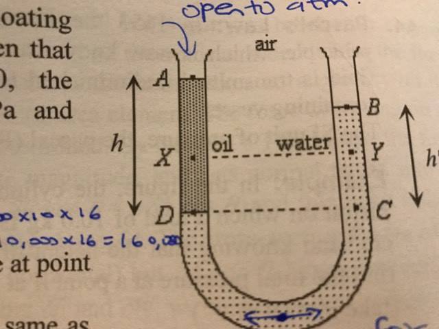

b) Consider the second figure shown. Why is the pressure the same at point C and D?
Why is the pressure at point X and Y different?
P=pgh
a) I'm not sure what the pressure is at point B. Sometimes I think the pressure is 0 but sometimes I think the pressure is P=pg(h1-h2) because the pressure is the same at all points on a horizontal plane.
b) The pressure at C and D is the same because they're at the same horizontal level.
The pressure at X and Y is different because they lie in different liquids (oil and water) so the density is different therefore the pressure is different?
  • Hand-annotated diagram of a connected vessel with points A, B, C, D and E marked, with heights h1, h2 and h3 labelled on the left and blue arrows marking h1 minus h2, h2 minus h3 and (h2 minus h3)/2.
  • Diagram of a U-tube manometer: the left arm holds oil above water with points A, X and D marked, the right arm holds water with points B, Y and C marked, and the air above both arms is open to atmosphere.
Sometimes you are correct. ;)
Correct.
In the same fluid at the same height, the pressure must be the same.
