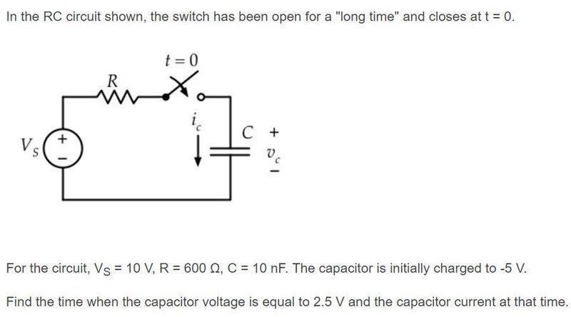

At initially, the switch is open meaning there is no current flowing. So how does the capacitor is initially charge to -5V? and what does a negative voltage capacitor means?
I thought it is only when the switch is closed (t=0) that when the capacitor is being charged.
Vc = Vs*(1-e^-t/RC)
Vc = Vs*(e^-t/RC)[/B]
2.5 = 10*(1-e^-t/RC), solving for t get me .000002s but this is not correct. The correct answer is .000004159s[/B]

Here is your attached file with the problem statement. Clearly, there is a potential difference of 5 V across the capacitor prior to he switch being closed.
Ok, so when t=0 the capacitor is initially charged to -5V but the source is 10V which mean it will try to charge the capacitor to match it value. How does the discharge and charging work at the same time? If it can;t be done, how does the capacitor discharge while the voltage source is still connected to it and has a higher potential value than itself. Where is the potential energy of the capacitor goes? In other word, where is the capacitor going to discharge the -5V when it is connected to a voltage source that has a higher potential.

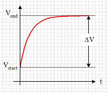

Vstart does not have to be zero; it can be any value, positive or negative.
It's simply going to follow an exponential curve from -5 V to +10 V.
In a circuit, current is driven by potential difference. It might help you to think of the circuit first in terms of the current that will be driven through the resistance.
Choosing the negative end of Vs as the zero reference, at time zero the left end of the resistor R will be at 10 V while its right end will be held at -5 V by the initial capacitor charge. That will produce some initial value for the current (what is it?). Eventually steady state will be reached and current will stop flowing (the capacitor's voltage will match that of the source voltage). So the current will start at some initial value at time t = 0 and end at zero after some time. That current will follow the standard exponential decay curve, and you should be in a position to write its equation drawing on the "stock" exponential decay expression (akin to your second Relevant Equation, but for current rather than voltage).
Now, knowing the current w.r.t. time you could write an expression for the charge on the capacitor over time and hence its voltage over time. Or, use that current equation to determine the potential drop across R w.r.t. time, and then use Kirchhoff to find Vc in the circuit. But a simpler idea is to just realize that the capacitor will be experiencing a total change in potential of 10 - (-5) = +15 volts. That is, it will follow an exponential "charging" curve starting at -5 V and ending at +10 V, of a total change of +15 V. You should be able to write an expression for a capacitor charging from 0 to 15 V. Then it's just a matter of "offsetting" that by the initial value of -5 V :wink:

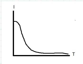

This is my understand, initially the current will be the maximum value when t=0 and when the capacitor getting up to the value of the source, there will not be any current (time to infinity). I've graphed the current vs. time
As for your question about the value of current when t=0. This is where I get stuck,

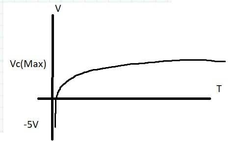

Vc(t) = Vf (1-e^-1/RC); where vf is when the capacitor has been charged for long time and it is now act as an open circuit. No current flow, which mean the resistor voltage is zero and the sum of the voltage drop across the circuit is now just E = Vf (final voltage across the capacitor equal to the source).
I(t) = Io*e^(-t/RC); the Io (I initial) is when t=0 the switch just closed. The charge across the capacitor is still zero as it can't change instantaneously. therefore, the initial current Io is just the Io=E/R. However this is not what we have in this case. We have a capacitor that was charged initial at -5V so they will be some current flowing to across the resistor from the capacitor as you have stated. I'm not sure how to modify the derived equation to account for this initial current of the capacitor.With the charging equation above: Vc(t) = Vf (1-e^-1/RC)
t=0, e^0 =1
Vc(t) = 1-1 = 0 (this need to be -5V to account for the particular problem that we have).
t= infinity, e^infinity = 0
Vc(t) = Vf (which is 10V)

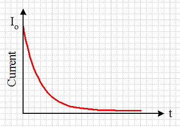

It will be a "standard" exponential decay:
What's the potential difference across the resistor? It's got 10 V at one end and -5 V at the other...

It's simple, and I gave you big hints in my previous post. You know the total ΔV that will occur, and that's the only part that applies to the exponential curve. You also have an initial "offset", that is, the initial potential across the capacitor. Those two facts alone (along with the circuit's time constant of course) are enough to pin down the equation.

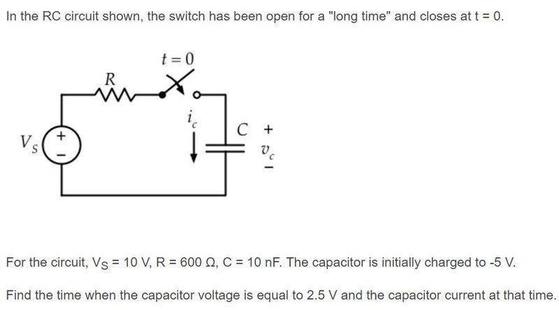

To expound on post # 14 by @haruspex, the solution of the diff. eq. is ##V(t)=V_A+V_B(1-e^{-t/RC})##. What should the values of ##V_A## and ##V_B## be to match the initial and final conditions?
##V_A## = -5
##V_B## = 15
The general DE eq after you account for the initial not equal to zero is
v(t) = ##V_s## + (##V_o## -##V_S##)##(1-e^{-t/RC})##
ace8888 said:
##V_A## = -5
##V_B## = 15
Right. So what do you get for the answer now?
4.1micro seconds.
