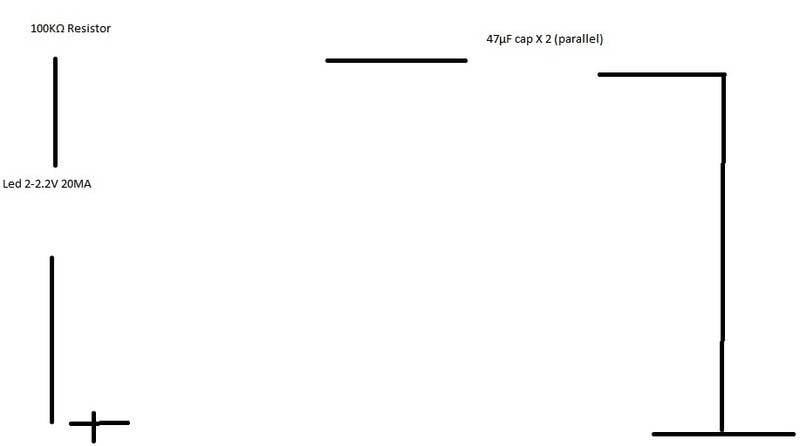

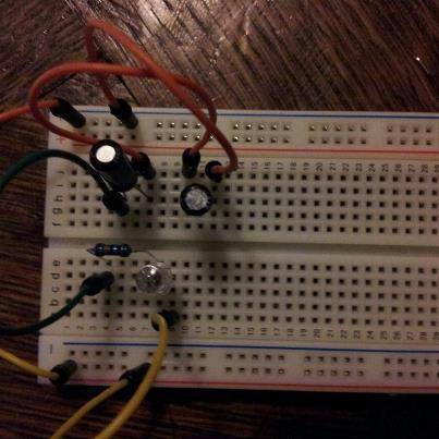

Here is my circuit:
http://caltechhelp.net84.net/ledrc.jpg
Electricity flows from the orange (-) to the positive (+)
Sorry for the late reply, I'm new here and had to upload the image to one of my servers (I'm a web developer)

Your image is getting blocked as a high-risk website. Can you just attach the JPG image to your post? Look for the paper clip icon in the edit window to upload an attachment.
I completely missed that, thank you! And that's because of my hosting service..

I know the schematic is horrid, but please bear with. Additionally i noticed my cap's were to smallin size, so i changed them. The led lit very dimly, then blew.
Yeah, you can't drive an LED through a 100k Ohm resistor.
You need to do something different to drive the LED. Are you wanting to have a couple second delay after throwing a switch before the LED lights up? You would need to add something separate to sense when the RC waveform rises above some level, and then use a transistor or something to drive the LED.
If you drive the LED from your 15V supply, you will need to choose a series resistor to drop about 13V (most LEDs have about 2V across them when lit), and set the current at 10-20mA (whatever the LED current spec is). For example, if you wanted 20mA through the LED with 13V across the resistor, the resistor in series with the LED would be 13V/0.02A = 650 Ohms.

That circuit looks an awful lot like a circuit for driving an LED using alternating current. The LED would rectify the small alternating current and the resistor would limit the current so as not to burn out the LED. The capacitor would couple the AC to allow enough current to flow to allow the led to light.
If you use DC then you would not get any current through the capacitors. I supposed if you had a very unfiltered DC power supply the ripple might cause the LED to light.
I am using a 15v dc 30mA power supply, which i found laying around and soldered/shrink wrapped breadboard jumpers on, for easy experimentation. Is it not possible to power though a capacitor this way?
A series capacitor blocks DC current. So no you cannot power anything through a cap in a DC circuit.
