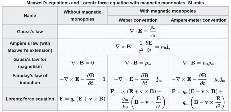

Are you claiming here that the arrangement of the signs in Maxwell's equations somehow rules out the existence of magnetic monopoles? It's perfectly possible to generalize Maxwell's theory to include magnetic charge- and current-densities (https://en.wikipedia.org/wiki/Magnetic_monopole):
Based on our current understanding, the apparent absence of magnetic monopoles in nature is an experimental observation, not a theoretical mandate.

Gavran said:
In the equation $$ \vec \nabla \times \vec B = - \mu _ 0 \varepsilon _ 0 \frac { \partial \vec E } { \partial t } $$ a magnetic field can force free magnetic monopoles to move, producing a magnetic current which will generate an electric field. This generated electric field will oppose the changes in the initial electric field and there is a minus sign in the equation.
No. Here you would need a plus sign, because the curl E in the extended Faraday's law has already the opposite sign as the magnetic current, see screenshot in posting #6 of @renormalize.

My apologies, but I still don't follow your argument. Can you please clarify: in your opinion, can the generalized Maxwell equations shown in post #6 (which include magnetic charge- and current densities) be valid and consistent in a hypothetical universe that does contain magnetic monopoles, or do you believe them to be somehow inherently inconsistent, thereby ruling-out such a universe?

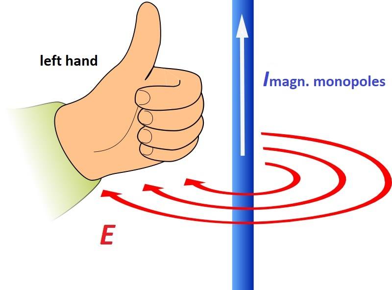

Gavran said:
The same thing can be said for the equation $$ \vec \nabla \times \vec B = + \mu _ 0 \varepsilon _ 0 \frac { \partial \vec E } { \partial t } $$ where in the case of regions with magnetic monopoles a plus sign in the equation would break the law of conservation of energy.
No, it would not break the law of conservation of energy because the minus-sign is already included in the generation of closed electric field lines around a magnetic monopole-current. For this you would apply the left-hand grip rule:
Source:
https://en.wikipedia.org/wiki/Magne...d_due_to_moving_charges_and_electric_currents
See also the signs in the extended Faraday's law in posting #6.

It is clear now.
The magnetic current is a fictitious current, but if it exists the magnetic current density in the equation $$ \vec \nabla \times \vec E = - \frac { \partial \vec B } { \partial t } - \mu _ 0 \vec { J _ m } $$ must be preceded by a minus sign because in the equation $$ \vec \nabla \times \vec B = \mu _ 0 \varepsilon _ 0 \frac { \partial \vec E } { \partial t } + \mu _ 0 \vec { J _ e } $$ the electric field generated by the magnetic current must oppose the changes in the initial electric field.
There is the right hand grip rule for the direction of the magnetic field generated by an electric current and there is the left hand grip rule for the direction of the electric field generated by a magnetic current. These two rules must be opposed to each other because they can not be in confrontation with the law of conservation of energy.
