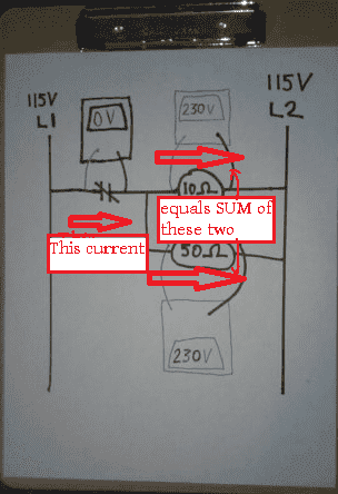

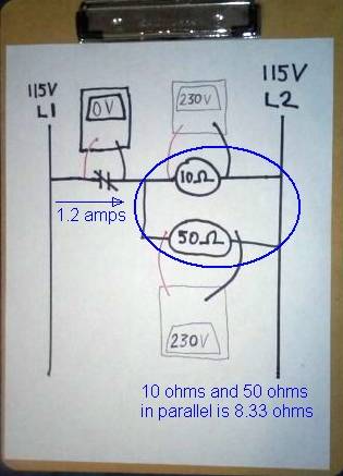

I'm fairly sure that everything I wrote in the diagram in the attached photograph is consistent and accurate, but I don't understand how this can be. The rules involved seem to contradict each other. I hope you people can reconcile this for me.
It's my understanding that in the diagram in the attached photograph, the multimeter reading the voltage across the contactor would read zero voltage because the current would bypass the multimeter because the multimeter is 20,000 Ohms of resistance. The contactor is almost zero Ohms of resistance. I understand that the current at the contactor will take the path of least resistance and bypass the 20,000 Ohm multimeter by going through the contactor. However, why, then, would the current not bypass the 50 Ohm resistor in the parallel circuit and just only go through the 10 Ohm resistor back to L2? It seems to me that the path of least resistance for the current from L1 to L2 would be from L1, through the closed contactor, and then through the 10 Ohm resistor, and then to L2.
If current will take the path of least resistance, why would the current not bypass the 50 Ohm resistor in the parallel circuit and just only go through the contactor and the 10 Ohm resistor back to L2?

When you have resistances in parallel current goes through all of them. The larger the resistance, the lower the current, but it is there. It even goes trough the multimeter (are you sure it is just 20 kΩ?), although it is very, very low there. Note: contactor doesn't have 0 Ω resistance - its resistance is definitely very low, but not zero.

My Question: If current will take the path of least resistance, why would the current not bypass the 50 Ohm resistor in the parallel circuit and just only go through the contactor and the 10 Ohm resistor back to L2?
Translation of your answer: Because in a parallel circuit, the current would go through the 50 Ohm resistor and the 10 Ohm resistor back to L2.
You didn't say why the current in a parallel circuit would not bypass the 50 Ohm resistor. You just said that the current would go through the 50 Ohm resistor. In the OP, I made it clear that I knew/know that the current will go through the 50 Ohm resistor. I appreciate your effort to help me understand, but you did not really answer the question.
You're saying that in a parallel circuit, the current goes through all the resistors. I'm basically asking why the current goes through all the resistors

Answer: it will NOT take the path of the least resistance. It will flow through ALL resistances.
You start with a wrong assumption, no wonder you end with a contradiction.

So in the situation presented in the diagram in the attached photograph, what would be the voltage reading on the multimeter across the contacts of the closed contactor?

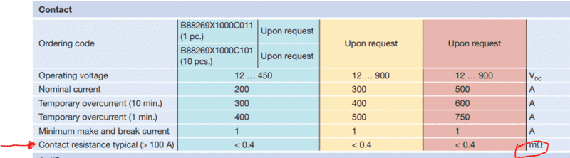

Actual values for contact resistance can be hard to come by on spec sheets, and falls within a relatively wide range, but for a set of largish contacts in good condition will be on the order of 50 microohms or less.
Lets say the contact in your circuit is 100 microohms ... what is the calculated voltage drop for the current you solved for before?
For example, voltage drop is 100 microvolts for 1 amp of current flowing through a 100 microohm switch resistance. Is the meter in question able to read this low a value?

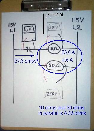

I don't know how to calculate voltage drop. Heck, I don't even know how to calculate the voltage in the multimeter on the contactor. That's what I am asking you.

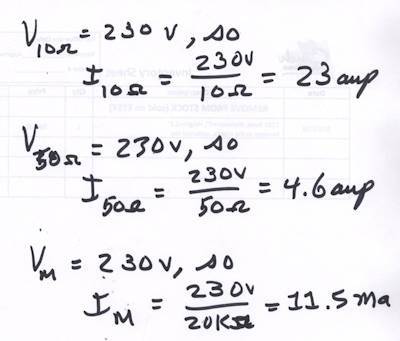

By Ohm's law, I am assuming that the current going through the 10 Ohm resistor is 23 Amps. And I am assuming that the current going through the 50 Ohm resistor is 4.6 Amps.

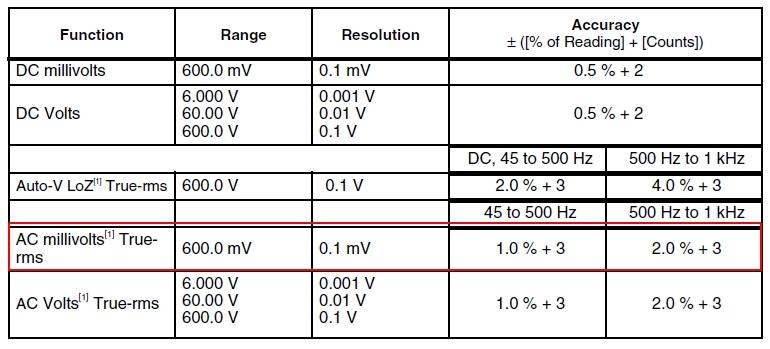

Been looking at Fluke 116 specs. Probably not a bad idea for you to dig thorough it as well.
Turns out meter input impedance is only 3,000 ohms when in auto-ranging mode.

It can be calculated. A short-cut for calculating the total resistance of two resistors in parallel is (R1*R2)/(R1+R2). For 10 and 50 ohms, this works out to 8.33 ohms.
Approximately 230V is across them (minus the unknown contact resistance), so since I=E/R the current is 230/8.33 ohms = 1.2 amps.
Consider a contact resistance of 100 microohms. Voltage drop is E=I*R, so with 1.2 amps through 100 microohms the voltage drop will be 120 microvolts (0.12 millivolts). Can the Fluke 116 read a voltage this low?
If it is set to the most sensitive (600 mV) AC voltage range, resolution is 0.1 mV. Measurement across a 100 microohm contact set will at best jiggle the display's least significant digit.
"Why measure voltage drop across a set of contacts at all then?" you may be asking. Because if they are in bad shape then voltage drop will be higher (sometimes, much higher - up to 230V, in this example, if they've blown completely open), and such tests are a useful troubleshooting tool.

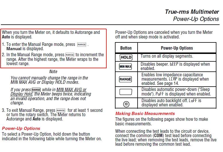

I don't know what auto-ranging mode is. As I said before, there is not adjustable voltage ranges on a Fluke 116 Multimeter. There is just a voltage setting for alternating current, and a different voltage setting for direct current, and that's it.
Range selection is shown on page 9 in the manual.

Excellent condition doesn't mean zero ohms. All real world contacts have some (hopefully, very small) resistance.
Your understanding is wrong. Neither current path is bypassed. Current flows through both branches, it's just that more current flows through the lower resistance branch. For the parallel branch consisting of the meter and contact set, most of the current goes through the contact set, and only a little current flows through the voltmeter. For the 10 ohm and 50 ohm relay coil branch, most of the current flows through the 10 ohm coil, and the remainder flows through to 50 ohm coil.
Use Ohm's law to figure out how much current goes through each coil.

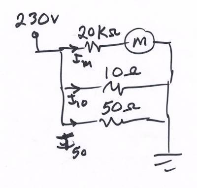

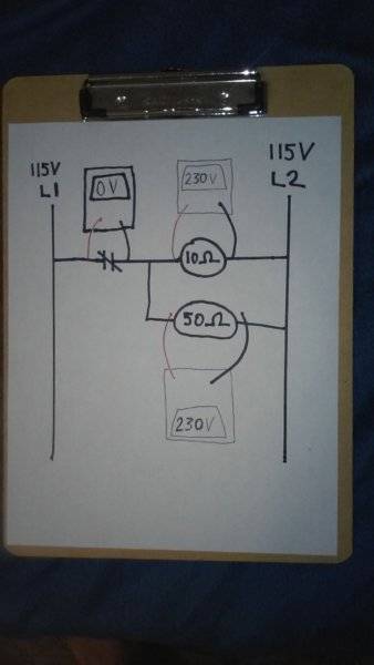

First off, the drawing is absurd. You have 115 volts on each side so the voltage across the elements is zero, yet you show it as 230 volts. Second, you have a variable capacitor shown apparently intended as a closed switch.
SO ... I have assumed that you mean that there is a voltage difference across the elements of 230 volts and I have redrawn the circuit that way, leaving out the closed switch (yes, it is not EXACTLY zero but we're going to assume that it is for now).
All this back and forth about what's doing what is just maddening to me. This is a staggeringly simple circuit. Here it is redrawn with your meter shown with a 20Kohm internal resistance in series with the galvanometer, and then analyzed:
There just isn't anything else to say about this circuit.
I'm a student at a trade school, majoring in HVAC. I'm fairly sure that my instructor would agree with me that since each leg of power is 115 volts, the voltage across the 10-Ohm resistor is 230 volts, and the voltage across the 50-Ohm resistor is 230 volts. I think that when my instructor speaks of when the voltage is 230 volts, he means the voltage difference is 230 volts. The way that I drew the ladder diagram in the OP is similar to how ladder diagrams are drawn in HVAC textbooks.
There is no variable capacitor in the ladder diagram I drew. The switch is a normally closed contactor.
I don't know what the difference is between saying the voltage across the resistors is 230 volts and saying the voltage difference across the resistors is 230 volts.
Please be patient. I'm a student at a trade school, majoring in HVAC, not an electrical engineer.
There is plenty to say. I need clarification. I still don't understand.
Does the 11 mA going through the multimeter stand for 11.5 milliamps or 11.5 microamps.?
Why does my instructor say that the multimeter would measure zero voltage across the contacts of the contactor in the ladder diagram in the attached photograph?

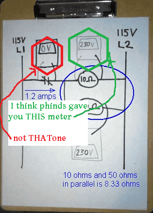

I think that after your thread on shorted condenser fan motor you are now equipped to grasp this one using just your intuitiion

That's SOOOO doggone close...

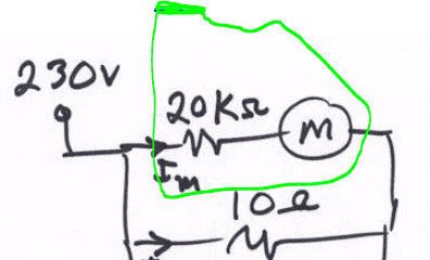

Go back to that concept of :"conductance", which is the open-ness of a path to current flow.
The contactor is in good condition meaning it welcomes current flow.
Its contact has conductance of many Mhos(Siemens) , hundreds of them in fact if not thousands.
which means it has Resistance of just hundredths (if not thousandths) of an Ohm .
Remember Ohm's Law Volts = Current X Resistance
and reconsider your statement
Is the resistance of the multimeter so high that the voltage is infinitessimaly small but higher than zero?
No, the resistance of the multimeter so high contactor is so low that the voltage is infinitesimally small but higher than zero !

I think I am getting a better understanding of this.
The information you told me on the thread about the shorted condenser fan motor certainly helped me understand this.
jim hardy said:
Okay.
See ? You knew that already.
Much of learning is discovering what we already know.
old jim
According to what phinds told me, the current going through the multimeter across the contacts of the contactor is: Current= 230Volts/20,000-Ohms
Current = .0115 amps
You said that the resistance across the contactor would be hundredths (if not thousandths) of an Ohm.
I will estimate the resistance to be .05-Ohms.
Therefore, Voltage= .0115 amp X .05-Ohms
Voltage= .000575 volts
Is that a reasonable estimation and calculation of the voltage going through the multimeter across the contacts of the contactor?One thing I don't understand: If the multimeter reads only .000575 volts across the contacts of the contactor, why did phinds calculate the current going through the multimeter across the contacts of the contactor using the equation Current= 230 volts/20,000-Ohm? If the voltage at the multimeter going across the contacts of the contactor is only .000575volts, why was phinds able to put 230 volts into the calculation of the current instead of saying .000575 volts?
If you put a voltmeter across a short it reads zero. The meter has a very high resistance and the short has very low. An ideal short has zero. In the real world I suppose the meter might have a microamp or two flowing through it. Because of the current difference, essentially nothing flows through the galvanometer so it reads zero.

Remember my quip about 'excruciating attention to detail in wording" ? I think there was a simple mis-communication. It happens.
He is right about the green one
and you are right about the red one.
old jim
old jim
Yeah, there are two different things going on here and my impatience got the better of me so I wasn't as careful as I should have been. My most recent post talks about the meter across the "contractor" (by which I assume he means the switch) and my previous post added the meter across the resistors.

But in phinds' diagram on the right on post #15 on this thread, phinds wrote: "V10= 230 V, so
I10= 230V/10-Ohm= 23 amp
V50= 230 V, so
I50= 230V/50-Ohm= 4.6 amp
Vm= 230 Volts, so
Im= 230/20,000= 11.5 milliamps"The Vm and I am parts of that diagram had to mean Voltage of the multimeter resistor and Current of the multimeter resistor.
Frankly, jim hardy, I'm not 100% sure what part of what phinds wrote that you are referring to when you say that phinds was referring to the 10-Ohm resistor.
Therefore, I still don't know the answer to the following question: Why does my instructor say that the multimeter would measure zero voltage across the contacts of the contactor in the ladder diagram in the attached photograph?

jim hardy, I think that the key to my understanding this lies in the following questions: If the multimeter reads only .000575 volts across the contacts of the contactor, why did phinds calculate the current going through the multimeter across the contacts of the contactor using the equation Current= 230 volts/20,000-Ohm? If the voltage at the multimeter going across the contacts of the contactor is only .000575volts, why was phinds able to put 230 volts into the calculation of the current instead of saying .000575 volts?
When phinds did the calculation to find the current, phinds had to be referring to the multimeter because phinds wrote: Current= 230 volts/20,000-Ohm . The only resistor in my diagram with 20,000-Ohm of resistance is the multimeter.
no, i think he was referring to the METER CONNECTED ACROSS the 10Ω resistor , the meter i circled in green.in your photo
this one in his sketch from post 15
a picture is worth a thousand not-quite-precise words ?
it is with considerable trepidation i venture to say what somebody else meant
but i feel pretty safe I'm right on this one. Corrections welcome.

Apologies for getting the math (wildly) wrong; @phinds numbers are correct, and I updated the sketch to match.
Lets view the question from another perspective. Fluke 116 meter specs for the default, auto-ranging voltmeter function "Auto-V LoZ" is a 600.0 V range with a resolution of 0.1 V. Per the manual, auto-ranging also "sets the Meter’s input impedance to approximately 3 kΩ to reduce the possibility of false readings due to ghost voltages."
We don't know what the contact resistance is (although we do know it ought to be very nearly zero ohms), the current through the contacts is 27.6 amps, and meter resolution is 0.1 volts. Solving Ohm's law for resistance (R=E/I), 0.1V/27.6 amps = 0.0036 ohms.
This particular meter will read contact voltage drop as no more than 0.1V when contact resistance is 0.0036 ohms (3.6 milliohms) or less. Chances are this is why your instructor claims it will read zero voltage. It depends on the characteristics of the contacts in question, but 3.6 milliohm (preferably, significantly less) would be necessary for a contact set capable of conducting this high a current. Why do I say this?
Power=Volts * Amps = I2R.
27.62 * 0.0036 ohms = 2.76 watts, and that translates to a fairly high amount of contact heating. For comparison, specs for a typical "ice-cube" relay with 6A rated contacts is 50 milliohms maximum contact resistance, which produces 1.8 watts (62 A * 0.05 ohms).
In your example circuit, if contact resistance was much higher than 0.0036 ohms they'd be dissipating even more heat, and would tend to be unreliable. For instance, power dissipation for a 0.05 ohm (50 milliohm) contact resistance at 27.6 amp is 38 watts. This is on par for a mid-range soldering iron heating element, and would fairly quickly burn up the contacts.
