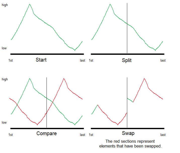

Why did I call this a "ZigZag" sort? ... in case anyone is interested.
After reading that original AACM article, I studied the algorithm and realized that it made for a good in-place sort for the reasons I described above. But before I adopted it, I wanted to prove to myself that it would really work under all conditions.
Of pivotal importance in this algorithm is the "Merge" operation. I'm using the term "Merge" loosely. What is actually done (as shown in the pseudo-code above) is that corresponding elements from two lists are compared and if needed swapped - so that the "smaller" (by collating sequence) is left in the first list and the larger is left in the second list.
But the sort will only work if the result of this "Merge" is that each of the elements of the first list is smaller than any in the second.
So I drew a chart for myself that showed the elements to be sorted along the X axis and their relative positions in the collating sequence in the Y axis. Before applying this Merge, the elements need to form a particular pattern in this chart. There will be a maximum and minimum element - and the elements need to be sequenced so that the collating sequence of all the elements between the min and max rise monotonically in both the +X and -X directions - with the chart wrapping around from the first element in the list to the last. If you think of the minimum element as the "Zig" is the chart and the Maximum as the "Zag", it has to be a simple ZigZag, with no extra Zigs or Zags (local minimums or maximums).
If you start with this ZigZag shape, fold it in half, and then perform the "merge", you get all the elements of low collating sequence in the first half, all those of higher collating sequence in the second half, and both of these sequences will have this same "ZigZag" property - allowing you to Merge them as well.

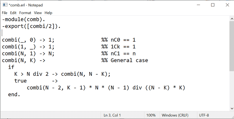

The other example calculates the binomial coefficient, ##~_nC_k##. This is something I've never come across in my reading. I've omitted the comments I have in the code, but I'll provide a brief explanation here.
If f(n, k) = ##~_nC_k##, a recurrence relation is f(n, k) = n*(n - 1) * f(n - 2, k - 1) / [ (n - k) * k].
So, ##~_nC_k## = n * (n - 1) / [(n - k)*k] * ##~_{n - 2}C_{k - 1}##. The division here is integer division, which is guaranteed to be exact by virtue of the numbers involved.
By symmetry ##~_nC_k## = ##~_nC_{n -k}##. For example, ##~_8C_5 =~_8C_{8 - 5} = ~_8C_3##. This is easy to confirm by writing a few rows of the Pascal Triangle, which contains the binomial coefficients.
This one isn't tail-call recursive, and I can't for the life of me figure out how to make it so. Previous attempts produced incorrect values due to the integer division being performed too early.
Interesting, I would have thought the compiler could have sorted it out (perhaps there is a higher level of optimization you can select) but I think you need
Code:
  true ->
    (N * (N - 1)) div ((N - K) * K) * combi(N - 2, K - 1)
Code:
  true ->
I'm not familiar enough with the compiler and its settings to know if I can adjust this.
Regarding your suggestion, I actually tried that, but got incorrect results, due to integer division being performed at the wrong time. For example, for ##~_5C_2## the factor to the left of the call to combi() is
$$\frac{5 \cdot 4}{3 \cdot 2}= \frac {20} 6$$
With integer division, this works out to 3. The other factor, from the call to combi(), is ##~_3C_1## or 3, so the result would be 3 * 3 = 9.
If the factors are placed in the proper order, you get ##20 \cdot 3 \text{ div } 6##, or 10, the correct value. I haven't run across any information about operator precedence an associativity, but it's almost certainly the case that multiplication and division are left-associative.
