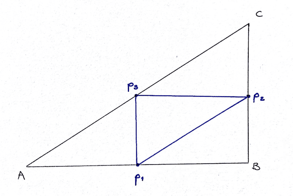

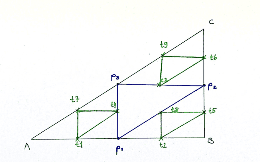

I even drew everything on the paper:
Hand-drawn diagram of triangle ABC with black sides and blue lines joining midpoints P1 on AB, P2 on BC and P3 on CA, forming an inner triangle.
Handwritten diagram of triangle ABC subdivided by blue and green lines, with points p1, p2, p3 on the sides and labelled points t1 to t9 marking the recursive subdivision.
I even drew everything on the piece of paper, so I understand the algorithm, but don't know how to write it in syntax.
What about plotting all the points? Is there a 'grid' for these arrays? I read about numpy.zeros(), but it was explained this is a function for matrixes, so I'm not sure how to implement this into the program.
Can you help?

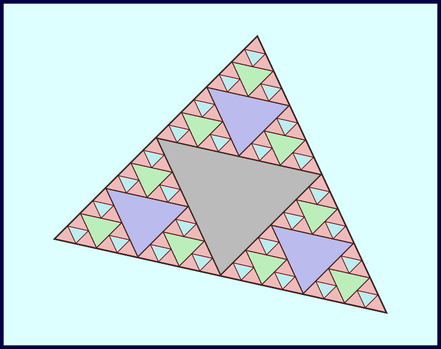

Plotting is more code than generating the triangles.
I tried it and sent the output to an SVG file (all in Pascal):
Recursive triangle fractal: a large equilateral triangle subdivided into smaller triangles in pink, green, lavender, grey and light blue, repeated at successively smaller scales.
Depends what language you are in. Here's the code to create the SVG in JavaScript:
