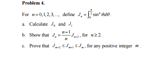

part c
Jm+2=m+2-1/m+2 Jm=m+1/m+2 Jm
hence Jm+2<Jm
should i expend Jm+2 Jm+1 Jm to the term J0 then compare them?
why the inequality is <= but not <?
should i use M.I to proof it??[/B]

Please stop using a bold font; it looks like you are yelling at us.
Anyway, what does your formula
[tex]J_{m+2} = m+2 - \frac{1}{m} + 2J_m = m + \frac{1}{m} + 2J_m[/tex]
mean, and where does it come from? Is what you wrote exactly what you meant? Do you need to use parentheses to make your expression clearer?
Use the basic property of integrals that if [itex]f(x) \geq g(x)[/itex] for all [itex]x \in (a,b)[/itex] then [itex]\int_a^b f(x)\,dx \geq \int_a^b g(x)\,dx[/itex].
