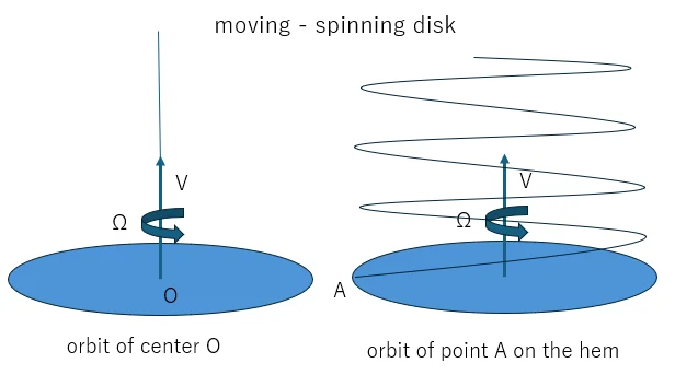

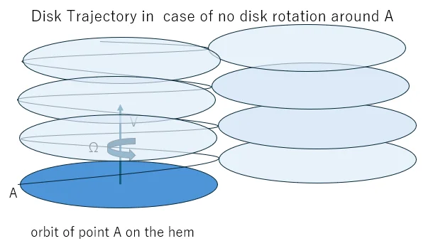

@gen x
Let us see the case of moving-spinning disk as sketched below.
Orbit of O is a line. The disk is rotating around O with ##\Omega## along the orbit.
Orbit of A is a helix. The disk is rotating around A with the same ##\Omega## along the orbit.

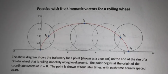

So answer from John Alexiou is not correct?
https://physics.stackexchange.com/q...he-bar-rotate-about-the-center-of-mass-or-not
From ground frame velocity at bottom part of car wheel is zero, that mean centripetal force is zero..
Here must exist centripetal force, why ground frame here show wrong result?
For top part of wheel I use peripheral veliocity or peripheral veliocity+ translation velocity to calculate centripetal force?
I think translation velocity dont have any effect on centripetal force so I use only peripheral veliocity
You haven't posted the math, that gave you the "wrong result" Are we supposed to guess what you got wrong this time around?
In the ground frame, a point on the wheel circumference is not moving on a circle, so how exactly do you define and compute the centripetal force in the ground frame?

gen x said:
math: Cf=m x 0^2 /r = 0
What is "r" supposed to be in the ground frame, where you don't have a circular path?
gen x said:
for ground frame centripetal force has different direction.
Again, how do you "define centripetal" force in the ground frame? And why do you expect it to have the same value as in the wheel center frame?
Only the total acceleration of the point must be the same in both inertial frames. But in the ground frame you also have tangential acceleration, because the point is not moving at constant speed. At the lowest point of the wheel, there is only tangential acceleration in the ground frame, vertically upwards, exactly equal to the centripetal acceleration in the wheel center frame.

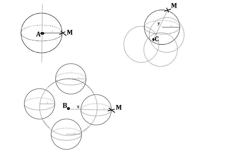

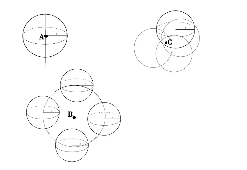

Centripetal force is Fc=mω2r
I see right away that r is different for cases, A(r), B(x+r), C(y)
Isnt it?

ω=7.292×10−5 rad/s
R=6.378×106 m
earth rotate around point A(CoM):
ameasured=g−ac
ac=ω^2R............. ac=(7.292×10−5)2×6.378×106≈0.034 m/s^2
ameasured=9.81−0.034≈9.78 m/s2
Earth rotate around point B, where x=50 000km:
r=5.0×10^7+6.378×10^6=5.6378×10^7 m
ac=ω^2r.............ac=300m/s^2
ameasured=9.81−300≈−290 m/s^2
centrifugal acc, higher than gravity...
etc.....

This acceleration is relative to an non-inertial point B, as opposed to the inertial point A.
No. When you use a non-inertial center of rotation, then you cannot equate relative (coordiante) acceleration with what an accelerometer measures (proper acceleration). You have to account for the proper acceleration of the reference point, which makes the math more complicated. As already said:
A.T. said:
- For dynamics, there are choices more convenient than others, but we still have the choice.
