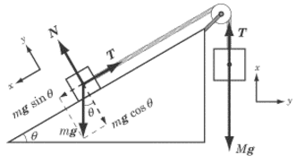

One closing comment on solving dynamics problems with multiple objects:
When there are two objects in the situation, we draw a a free body diagram for each object and attach a set of Cartesian coordinates to each FBD. The two sets of Cartesian axes can be oriented differently with origins located in different places (where the two objects are). That implies there are two different coordinate systems at the same time. But in general we fix one single coordinate system and refer all kinematic quantities to that initial coordinate system. How do we resolve this situation, i.e. the fact that we can have multiple coordinate systems at the same time?

Pick a coordinate system, express all quantities using that coordinate system, and solve the relevant equations. Then, if desired, transform to a different coordinate system to express the final result.
Free body diagrams need not have coordinate systems. You use coordinate systems when describing vectors in terms of coordinate tuples e.g. (x,y,z), or (r,theta).
It may sometimes be convenient to split the problem up into pieces, using a different coordinate system for each piece (so that some quantity can be ignored or some symmetry exploited). If one does this, it is important to keep track of what frame is being used at any given time and not "frame jump", taking an expression from one frame and calculating with it willy-nilly in another frame without having transformed it first.

We split the problem up into different parts (see two blocks connected by a rope, one block on an ramp and the other hanging in the air from a pulley) to come up with equations that we then relate to each other via the constraint equations.

Ok. I see. Check the figure below:
In this case each block has its own FBD and the two scalar components equations are written according to the Cartesian axes orientation. Once this is done, we have 4 scalar component equations where some of the terms are related to each other (tension has the same magnitude, net acceleration has the same magnitude, etc.)
The fact is that we solve this problem using multiple coordinate system instead of a single one. Things can be combined regardless of that.
