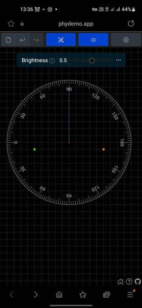

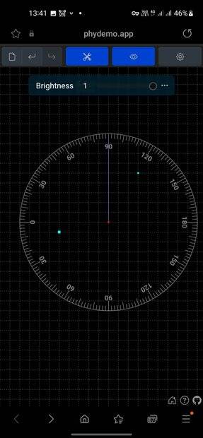

The first picture is the normal reflection rule on the glass which is the line drawn in the middle. The green dot is the light source, the orange one its reflection. In the second picture, the left dot is the same source, but I want it to be reflected on the right side where the right dot is (around that area). Without the plexiglass changing its angle.

In neither case do I see this as "reflection", unless you mean that the orange dot represents where the green object appears in the plexiglass to an observer at the green dot.
To an observer at the glass not the green dot. The observer looking through the plexiglass sees the orange dot as the reflection of the green dot.

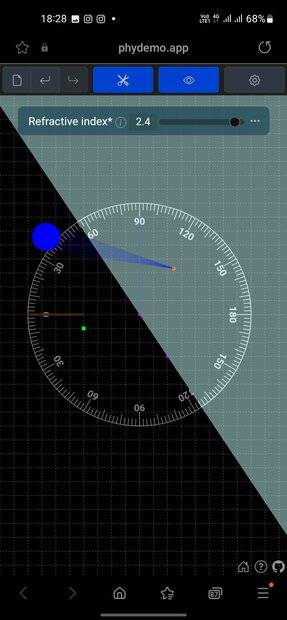

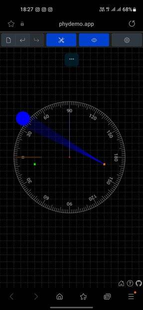

The second pic contains an observer(the blue circle), a plexiglass in front of it at a position of 9p degrees. A light source (the green dot) which is blocked by a brown line (cardboard or something). The orange dot is the reflection of the light source lighting the actual object(the green dot). The first pic is where I want the object to be reflected. Under the light source cannot be seen by the observer. And the right side of the glass, you can imagine as a stage. Are you at all familiar with the pepper's ghost illusion? That's what I want to achieve, except that I want the glass to be at 90 degrees, not 45.

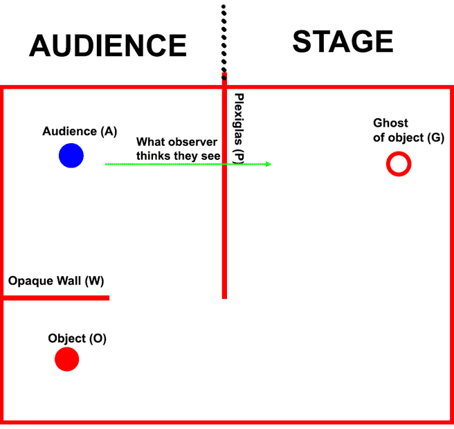

It is vital that we understand the function and the context of your ask.
This is the best I can make of your description.
Is it about right?

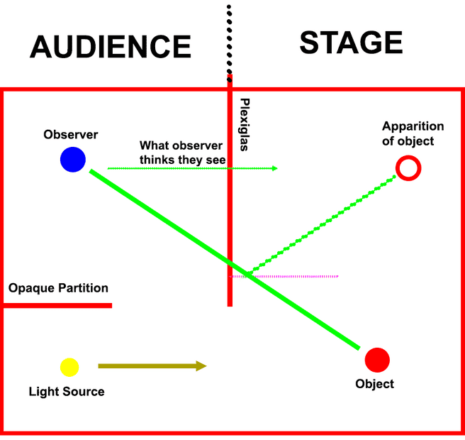

You're not going to like it. At the very least, you're going to need a mirror between object and apparition of object. i.e. the dotted magenta line.
Is it about right?
That's 99 percent accurate, thanks for the effort. But the object is the same place as the light source, the partition actually blocks the object from being seen. The yellow light is shone from the ceiling, so the yellow light and the red object in your demonstration are actually in the same place, left that is. And another thing, for the effect to take place, and for the observer to be able to see it, it has to be reflected through the plexiglass.

OK, that changes things.
I've given everything single letter labels since I suspect we'll be talking geometry pretty soon.

I think the problem is that you are asking for something that can't be done the way you want it. You're going to need mirrors where you don't have mirrors. And yes, they're going to have to be 45 degrees to the angle of your walls.
I can see a problem that going to arise regardless of the solution. The apparent path length A-G is going to appear to the audience as long as the actual path length A-?-O. If A-O is longer than A-G (say with multiple mirrors), the apparition is going to look too far away.
I'm ok with having mirrors, I just don't want the audience to notice them. The stage is supposed to be a kitchen, and the plexi, the glass door to the garden or something. I'm just saying if the object is not reflected through the plexiglass, the audience wouldn't see it on the stage, that's why the partition doesn't stretch all the way to the plexiglass, because then the audience wouldn't see anything.
What you say is a problem, yes. The length of both paths has to be calculated.
