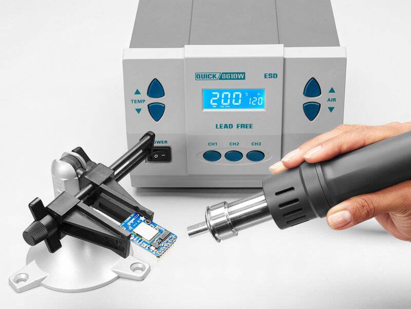

How big is the section of the SMT PCBA that you want to solder? For small areas, Hot Air SMT Rework wands are common to use. For anything bigger than a square cm or two, you will need at least a small reflow oven to solder your PCBA.
https://www.adafruit.com/product/3941

One issue is dealing with closely-spaced SMT components. As you solder one, you can desolder an adjacent one and blow it askew on its pads. You can get directed nozzle attachments that can mitigate this, and you can design your PCBAs to be easier to rework/solder (space the components out more, which results in increased PCBA area and cost).
How many PCBAs do you need to solder? What size components are used, and how closely are they packed?
Depending on the size of elements involved blowing them out can be a serious problem. Low airflow helps, but only to some extent.
