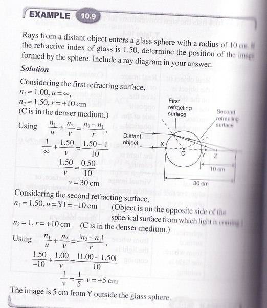

I was kind of confuse with the use of refractive index.
For the first part of question, n1 = 1.00 and n2 = 1.50. From what I know, the object is at vacuum so the n1 = 1.00.
But why for the second part of the question, n1 = 1.50 and n2 = 1.00 ? After the first refracting surface, the image should be at the vacuum too. But why we use n1 = 1.50?

I assume that the light starts by going into the sphere from the air (or vacuum), so it's going from n = 1 to n = 1.5;
then it travels through the sphere (n = 1.5) until it hits the opposite surface and comes out again, so it's going from n = 1.5 to n = 1. :wink:

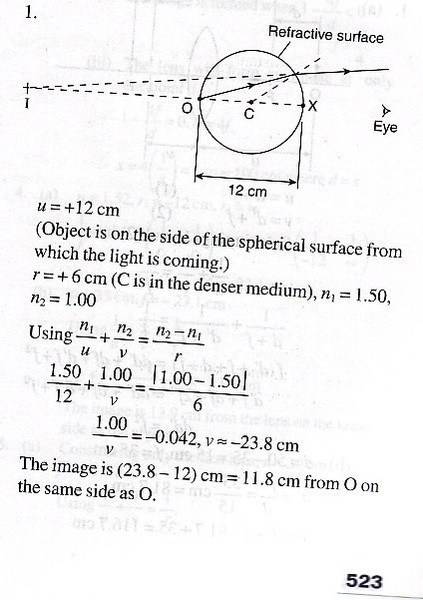

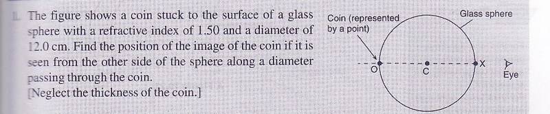

Now I came across with another question similar to this question(quite similar)
Quenstion:
Answer:
Why the n1 is 1.50 if we say the light starts from vacuum?:confused:

Because the light starts from the coin, inside the sphere, not from vacuum. :wink:

Look carefully at the arrows in the figure. Where do they start from?
EDIT: to clarify, look at the interface where the two rays meet. The ray arrows indicate they go from the glass into the air.

Oo, I got it.
