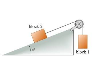

In this problem, the fact that the length of the string does not change imposes a constraint on relative accelerations of the two blocks. Find a relationship between the x component of the acceleration of block 2, [tex]a_{2x}[/tex],and the acceleration of block 1. Pay careful attention to signs.
Express [tex]a_{2x}[/tex] in terms of [tex]a_{1x}[/tex] and/or [tex]a_{1y}[/tex], the components of the acceleration vector of block 1.
(the diagram is included)

Hint: How must the total accelerations of each block be related?
Equal?
polymerase said:
Equal?
Exactly!
Doc Al said:
Exactly!
so...a_2x = a_1y?
polymerase said:
so...a_2x = a_1y?
Nope. Block 2 is on an incline. The magnitude of its total acceleration equals that of the other block, but they travel in different directions (obviously).
(I assume that x & y are horizontal and vertical. If x means parallel to the plane, then you are almost correct.)
(I assume that x & y are horizontal and vertical.)
...therefore FINAL answer is...a_2x = -a_y1??
If the x-axis is parallel to the incline for mass 2 and the y-axis is vertical for mass 2: Yes!
