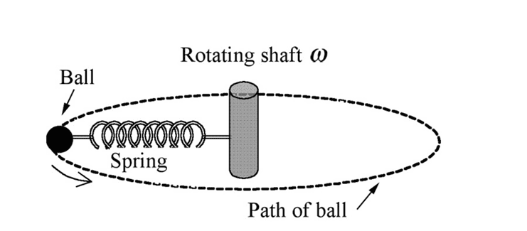

an ball of mass m is connected by a string with spring constant k, to a rotating shaft.
Find a relation between the radius of the circle, and the angular frequency.
Let:
Natural length of spring = x0
Extension of spring = x
Radius of circle = r = x + x0
Centripetal force = Force due to spring
mrω2 = kx = k(r-x0)
Make r the subject,
mrω2 = kr-kx0
kx0=kr-mrω2
kx0=r(k-mω2)
r=[itex]\frac{kx_{0}}{k-m\omega^{2}}[/itex]
The expression indicates that there is an asymptote when [itex]\omega=\sqrt{\frac{k}{m}}[/itex]
Does this means the rotation can never hit this angular velocity?

Yes. You can also express ω in terms of r:
[itex]\omega=\sqrt{\frac{k}{m}(1-\frac{x_0}{r})}[/itex]
ω would be equal to the "natural frequency" at infinite radius.

If the object performs SHM, the angular frequency is √(k/m) neither higher nor less. Now the object moves along a circle. r is its distance from the origin. It can not be negative. So ω can not exceed √(k/m)

So what happens if I attach a motor to the rotating shaft and drive the shaft at an angular freq higher than √(k/m)?
The spring would break or deform. Hooke's law isn't an exact law, its just an experimental approximation for stresses below a certain threshold. You would cross that threshold by pumping omega, since the spring can only stretch out so far. Springs stop being springs (perhaps permanently) when you stretch them beyond their limit.

The relation between r and ω holds for the stationary solution. In real life, everything is in rest initially, before switching the motor on.
The motor exerts some torque τ, and the torque accelerates rotation: dω/dt=τ/I. The moment of inertia I=mr2 increases with r as ω increases, and the applied torque becomes less and less effective to increase ω.There is a limit for ω that can not be exceeded by a given torque.
