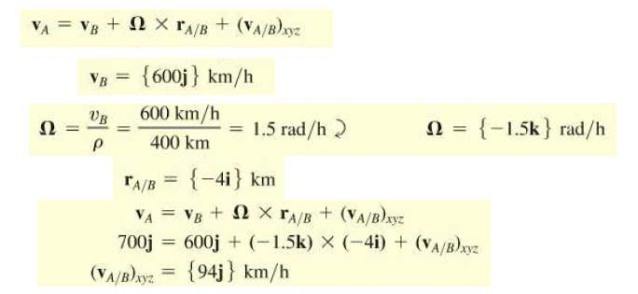

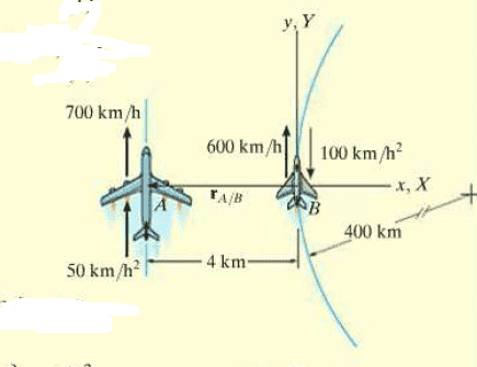

My friends and I have discussed and have no idea how to solve.
So we looked at the textbook.

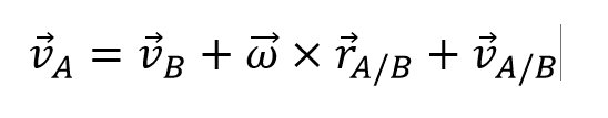

We were told to use this equation.
In this equation, A/B means 'A respect to B'
Also, the equation is derived based on an intermediate frame attached to point B, which is rotating at [itex]\omega[/itex].
In the textbook's solution below, however, the intermediate frame is attached to point B, but the [itex]\omega[/itex] is to the right of the frame (the centre of the prescribed circle). The [itex]\omega[/itex] is no longer about the frame through point B.
Hence, we have our suspicious of the textbook solution.
Anyway has got any idea if we're wrong, or is the textbook wrong?
ω is the same everywhere in a rotating frame.
