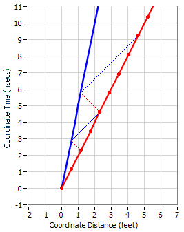

Let me be clear Let's suppose we are observing to objects one of them is moving 0.5c and the other one 0.2 c so there is relative velocity (Supoose these are the vectors and they are parallel)
I know it but I want to show it in space time diagram
What do you mean by "show it" in space time diagram? ghwellsjr has already shown them to you. Each of the lines in his space time diagram represents a different object moving at a different speed, up to light traveling at "c" for the red lines.
If we just pick out the two lines for those speeds in my diagram from post #3, there won't be any obvious way to see or determine the speed of one of them relative to the other but if we add in markers (dots) for the Proper Time of one of them, say the one that is traveling at 0.2c, then we can show how it can establish the speed of the other one by sending light signals to the other one and timing the reflection. This works just like a laser range finder except that it also registers the time when the signal was sent and when the reflection was received. Here is a spacetime diagram showing the process:
Spacetime diagram with coordinate time in nanoseconds on the vertical axis and coordinate distance in feet on the horizontal axis; a thick blue line and a thick red line start at the origin, with the blue line steeper, and thin blue and red signal segments with light-speed reflections connect them at several points.
The blue object sends out its first signal (in blue) at its time of 2 nanoseconds and it receives the reflection (in red) at its time of 4 nanoseconds. It assumes that the signal took the same amount of time to get to the red object as it did for the reflection to get back and that it traveled at c, one foot per nanosecond, so it places the red object at 1 foot away at its time of 3 nanoseconds. Do you understand the math or do you want me to go over it?
Then the blue object sends out its second signal at its time of 4 nanoseconds and it receives the reflection at its time of 8 nanoseconds. So it establishes that the red object was 2 feet away at its time of 6 nanoseconds. Now it can establish the speed of the red object relative to itself by taking the differences between the distances divided by the differences between the times. Its calculation is:
(2-1)/6-3) = 1/3 = 0.3333c
If you check the relativistic velocity addition formula, you will see that this is correct. That calculation is:
(0.5-0.2)/(1+(0.5)(-0.2)) = 0.3/(1-0.1) = 0.3/0.9 = 0.3333

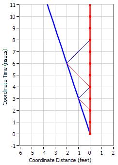

We can also transform from the above IRF to the one in which the blue object is at rest and we directly see that the red object is traveling at 0.3333c relative to the blue object:
Spacetime diagram with coordinate time in nanoseconds on the vertical axis and coordinate distance in feet on the horizontal axis; a vertical blue line marks the stationary object, and a red line rises diagonally from the origin, with light-signal paths drawn between them.
Note that it doesn't matter when the blue object sends out its signals, the final answer will always be the same. And we could have done the exercise from the point of view of the red object; it, too, would establish that the blue object was moving away from it at 0.3333c.

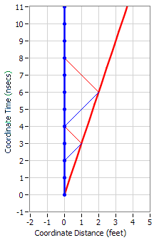

In fact, here are the diagrams showing how the red object would establish the speed of the blue object.
First, in the original IRF in which red is traveling at 0.5c and blue is traveling at 0.2c:
Spacetime diagram with coordinate distance in feet on the horizontal axis and coordinate time in seconds on the vertical axis, showing a blue line and a red line rising from the origin, with thin black and red construction lines between them.
And second, the IRF in which the red object is at rest:
Spacetime diagram with coordinate time in secs on the vertical axis and coordinate distance in feet on the horizontal axis, showing a vertical red worldline at distance 0 and a steeper blue worldline, with thin red and blue light-signal lines meeting at events on the worldlines.

I'm curious ghwells, do you have a program to generate these diagrams, or do you make them "by hand" for each thread? That would seem really tedious. haha

From the spacetime diagram above,
with the two radar times since their meeting event (at t=0): we have t=4 (send) and t=8 (receive),
the relative speed is (dx/dt)= ( (8-4)/2 )/( (8+4)/2 )=4/12=1/3
and their doppler factor is sqrt(8/4)... all in the spirit of Radar Measurements and the Bondi k-calculus.
Check that sqrt(8/4)=sqrt( (1+(1/3))/(1-(1/3)) ) [copy-paste the RHS into a google search].
I wrote my own program to draw the diagrams but sometimes I have to edit them "by hand" in Paint.
